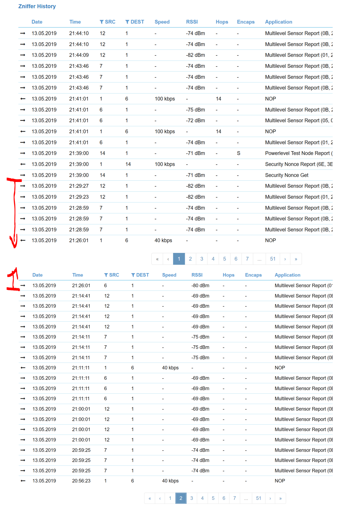

I placed three battery powered sensors (no. 6, 7, 12) at places where there is no stable connection to the gateway (1). Then I added a range extender (no. 14) between these sensors and the gateway. Since then they work much better. Every 15 minutes three or four report’s per sensor are now received.
For testing I unplugged the range extender (from 21:21 till 21:37, see attachment). During that time communication to no. 6 completely failed and communication to 12 partially failed. This makes clear: 6 and 12 use 14 as a hop. But at > 99 % of the monitored connections the zniffer history doesn’t show this hop. 21:39:00 and 21:41:01 are the first and only times I ever saw this column filled. Why doesn’t it show the hop?

you only see the the information about the hops if the Controller is sending to clients.
as far as I can see you don´t need the Repeater, as your clients are reaching the controller
also without. But, you can see a better connection with the repeater, 100 kbps against 40kbps.
Regarding the route view, i realized that this may be updated after days.

enbemokel is correct - standard Z-Wave library reports only outgoing packets routes.
If you check our latest 5.37 (will become public this month), you will have also incoming packets routes. This is a cool feature avait only in Z-Way.
