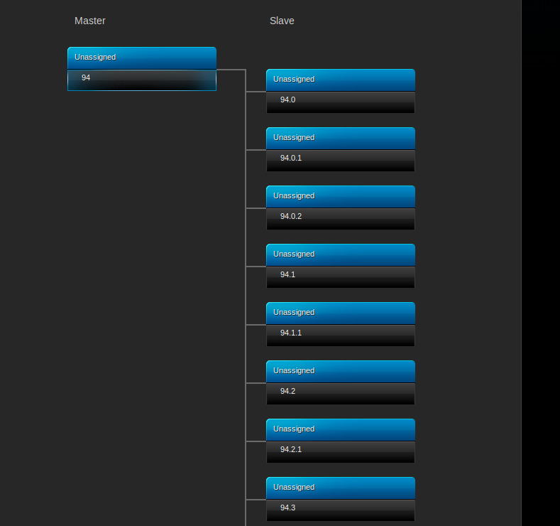

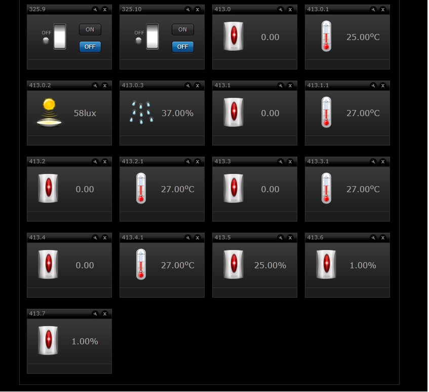

But problem is:
Temperatures are not updated or incorrect channel temperature is updated
Only the luminance and humidity channels works OK
Same problem with two Z-unos
HC2 z_uno kanavat.jpg (104.34 KiB) Viewed 130166 times

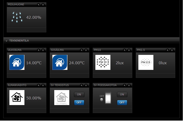

Problem solved.
Z-uno working fine, if I use only three different MULTILEVEL channels.
I used TEMPERATURE, HUMIDITY and LUMINANCE.
I also added one SWITCH_BINARY.
If I added other same type channel, then part of channels goes mixes?
I also tested ten SWITCH_BINARY channels same time without MULTILEVEL channels,
they all works fine.
Picture shows the channels of two Z-Uno.
Small mistake is that the air quality PM2.5 and PM10 are lux
2 x z-uno.jpg (65.71 KiB) Viewed 129870 times

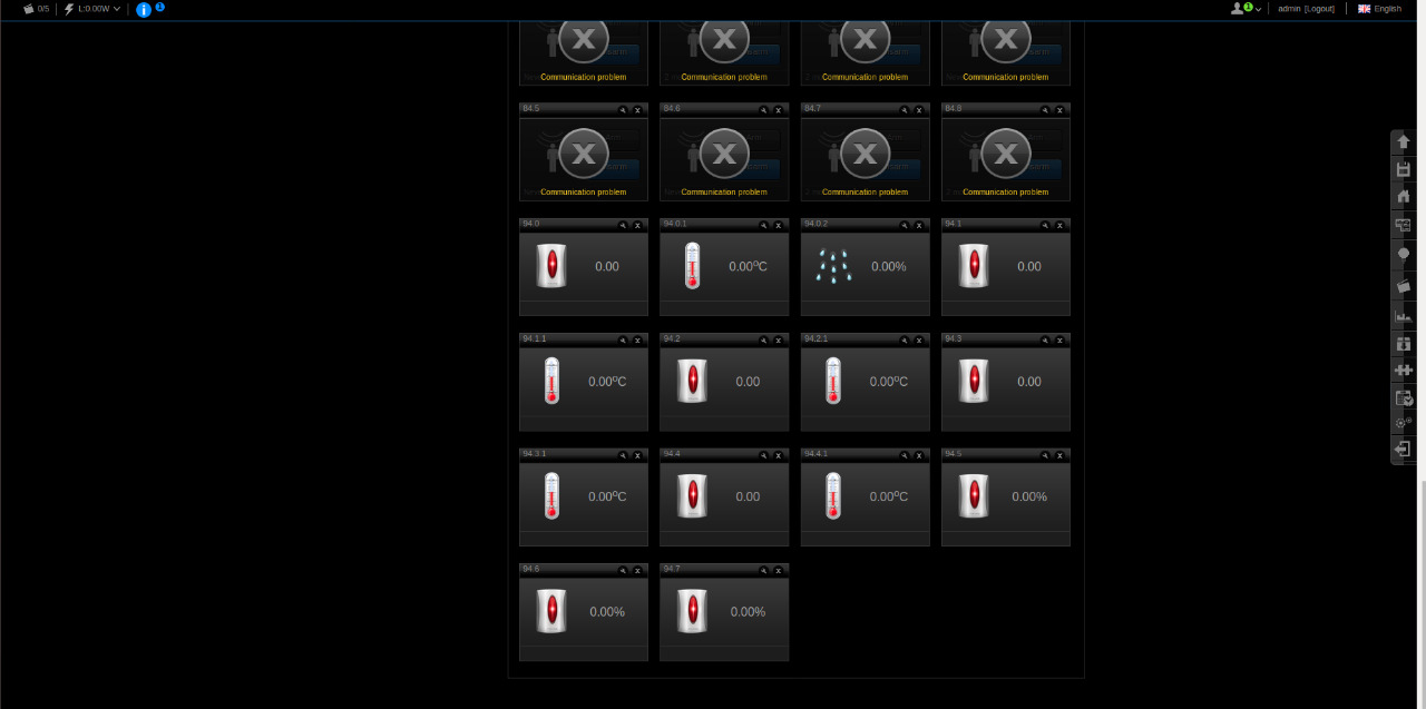

Did you solve this problem?
I have a very similar problem.
My Z-Uno had connected -
8 Binary switches operating an 8 channel relay board
2 Temperature sensors, Ranging -30 to + 30
1 Power meter
1 Lux sensor
This was all working fine, I upgraded the firmware to 2.1.5 and now I am struggling to get all the sensors to give sensible values again. I too have a Fibaro HC2 and I also exclude the Z-Uno and upgrade the Z-UNO doing an upload, then re-add the Z-Uno. I can get 10 devices working ok, when I exceed this it goes weird.
Re: Z-uno all channels do not work with HC2
We will release a 2.1.6 soon. That might help with your issue. Should already be in test repo (if you know how to access it).

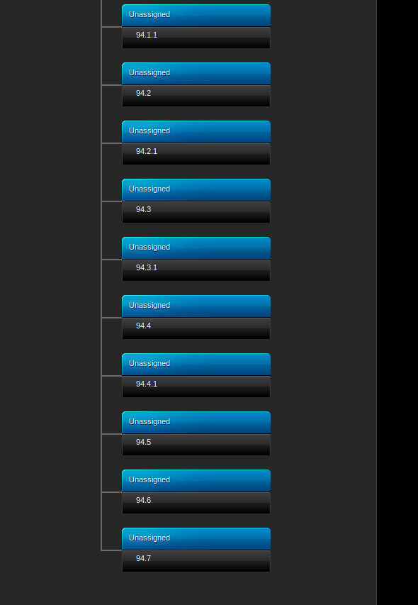

Yes, I have same problem.
If I install z-uno to HC2, then comes notification: "Devices without templates"
I tried 3 different z-uno
HC2 software Version:4.550
