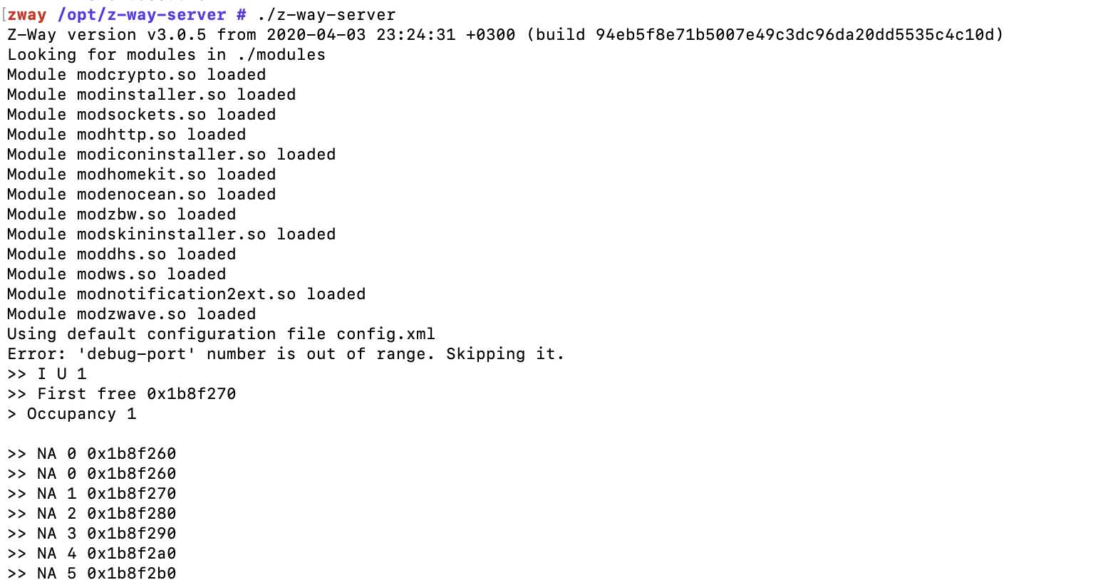

We have just released v3.0.5. Not in the repo yet, but you can already test it from https://storage.z-wave.me/z-way-server/ ... _armhf.deb
Quite a lot of bug fixes. See the Change Log https://storage.z-wave.me/z-way-server/ChangeLog
