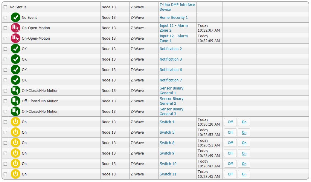

I'm unable to get more than two inputs working. None of the outputs are working, and when I control one of the outputs via Homeseer, it shows that two of them are being controlled.

When I apply or remove Gnd to inputs 11 or 12 they are instantly recognized in homeseer, and the status is updated. That same test does not work for ADC0-4.
When I click the On or Off buttons in Homeseer for Switch 4,5,8,9,10,11, they seem to be working in Homeseer, and the status is updated, but nothing happens on the Shield outputs(I do see the red LED flicker on the Z-Uno when I do this). One exception to the above statement is that if I click the On button for Switch 8, both Switch 8 and Switch 4 turn on. This only happens with the Switch 8 On button, not the off, or either button for Switch 4.
I've attached a screen shot of how HomeSeer is displaying the device. Let me know if I've left out any important details.

Update: I've changed the configurator to have ADC0-4 setup for "Digital Input 0/3 V" rather than 0/12 V, and updated the Jumpers to match the new configuartion. They are still configured for "Free or ground", but now the other inputs are working. Also on the output side I noticed that all of the PWM1-4 outputs are providing Open regardless of the switch state in HomeSeer, while 7 and 8 are providing ground regardless of switch state.
