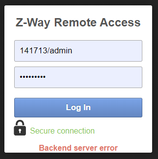

The android app says that the hub isn't connected, and when I try logging in at find.z-wave.me I either get "Backend server error" or it just returns me to the same login page over and over again...

How does all this explain these messages I'm getting when I'm trying to log in?
Screendump
Screendump
