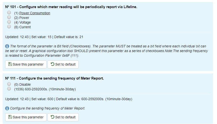

Incorrect config Template for Aeotec SmartSwitch7
Post by michap »

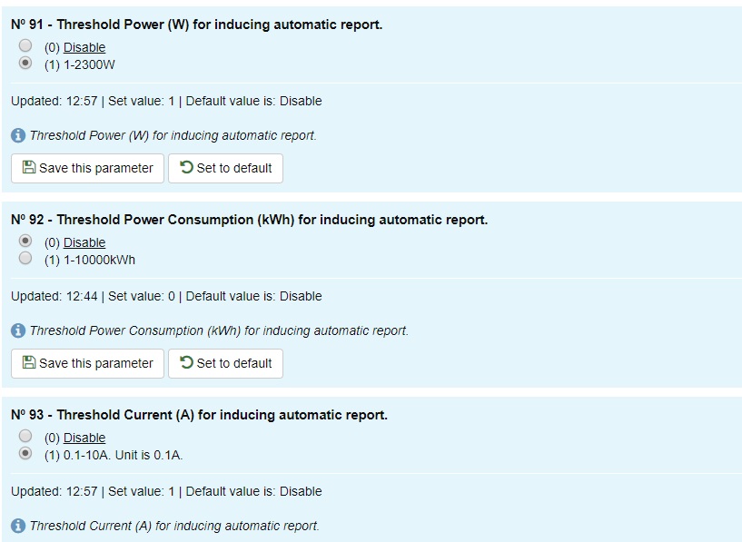

in version 3.0.0 is the configuration template not correct.
Instead of checkbox for multple selection or value input here are radio elements.
Anway, change of parameters can be done using the expert commands ;)
Re: Incorrect config Template for Aeotec SmartSwitch7
It is a problem in the description file from the Alliance, not in v3.0.0
michap
Posts: 443
Joined: 26 Mar 2013 10:35
Contact:
Post by michap »
you mean https://products.z-wavealliance.org/Products/3437/XML ?
So it cannot be corrected in/for Z-Way?
Michael
It can. You can make a copy and edit it. We don't have the device to test it unfortunately
