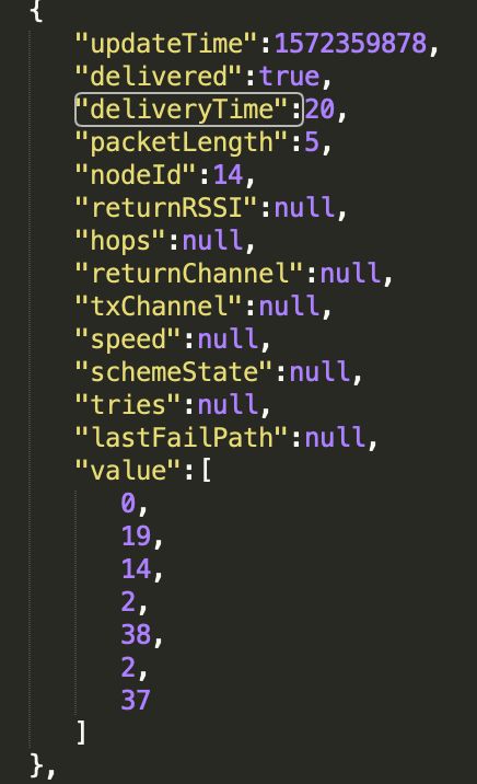

I’ve a problem, I would like to get access « Timing info » data from UI Expert.
I run z-way server on Raspberry Pi3B+ with firmware v2.3.8.
I have found « LastPackets » in file zwayoriginPacketsjson in opt/z-way-server/automation/storage directory but there is only « DeliveryTime ». (attach file)
However, I would like to know if packets are red, black or green and also the route of packets (which devices).
I think data exists but I don’t know where is it.
Thanks,
Capture d’écran 2019-11-01 à 10.17.23.png (73.5 KiB) Viewed 5054 times
Re: "Timing Info" data on UI Expert
red is delivered = false, green/black is just deliveryTime > 20 ms
