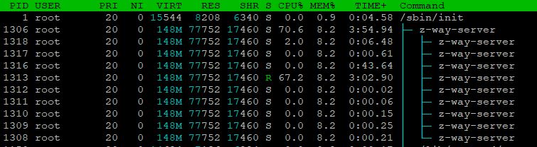

Hej,
I have upgraded my Raspi3 (4core, 1MB RAM) to Buster and z-way 3.01.
After a couple of tries this finally works, but performance is really bad.
Using the GUI, I'm getting "Request failed..." or "Connection refused by the z-way-server" many times, response times are quite bad (not ms, more seconds or minutes), etc.... The attached monitoring solution (icinga) complains much about the same issues.
Checking on the process status, I can see 9 sub-processes/thread under the main (see attachment).
One process is doing the main stuff (almost 80% of one core), one other is also working, but using just 50% of the proc time of first process ... and all other threads are doing almost nothing !

- z-way-performance_threads.JPG (55.53 KiB) Viewed 9317 times

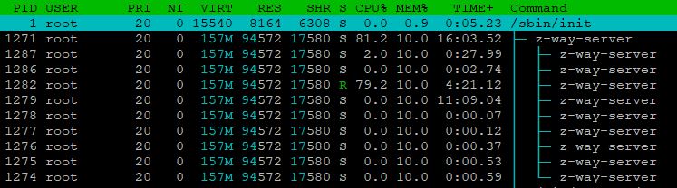

- Capture2.JPG (53.78 KiB) Viewed 9157 times

Re: z-way 3.01 Performance
WA state is alomost zero for each core.
Just if z-way-server wanted to read from its module, I can see short peeks there.
Somehow expected.
Somehow expected.
