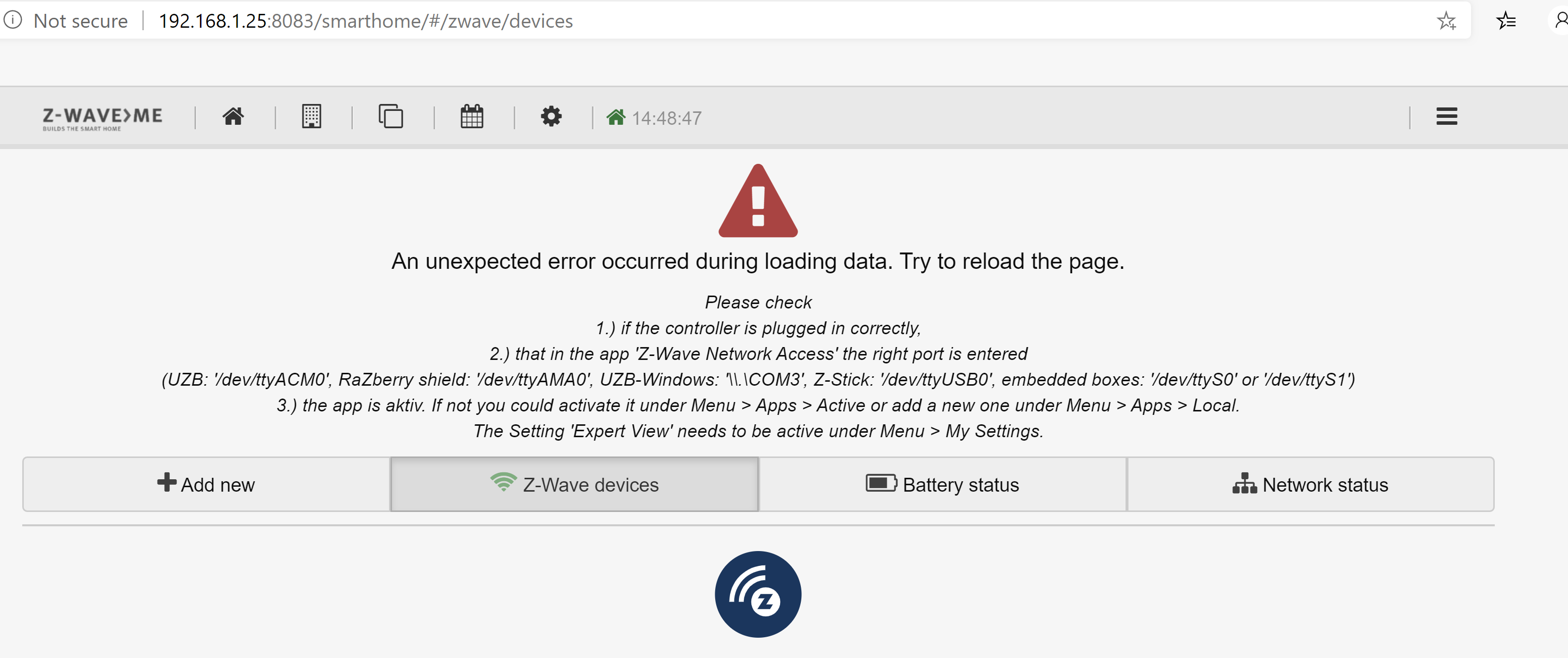

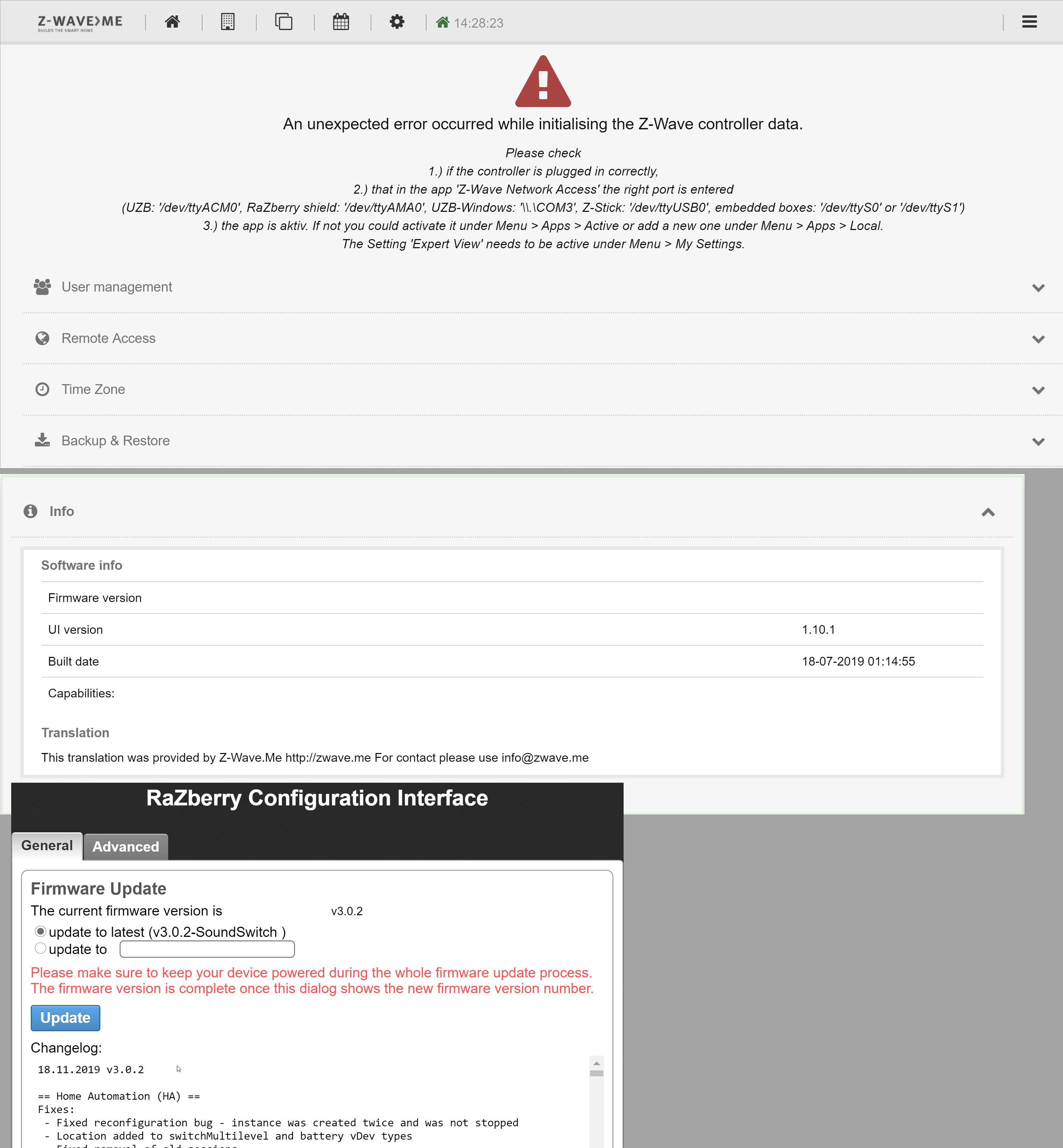

I recently upgraded RaZberry to 3.0.2 and I started having several problems.
First, I get "error_load_data" and "An unexpected error occurred while initialising the Z-Wave controller data."
in the log, the main error that I have found was:
[E] [HTTP] Callback execution error: TypeError: undefined is not a function at WebServer.document_root (automation/Webserver.js:35:11)
that is called quite a few times.
Manage or AddNew devices does not show the list of existing devices.
if press on "Add new Z-Wave Device and identify it automatically", and the try to exclude a device, for example, nothing happens and I see that Webserver.js:35:11 error comes in the logs.

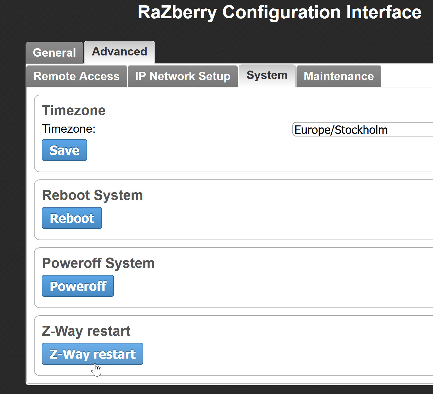

I got is solved by going to the Firmware Update > Advances > Z-Way restart. After that everything is back to normal. I did miss some of the devices that I previously added, but I am not sure if it is because of that error or it happened during the upgrade from 2.x.x to 3.0.2.
It is strange that I did sudo reboot via SSH and tried re-plugging the power cable on PI and it did not help. So, it could be that is it just a combination of some other events or something else that fixed the error. If it ever comes back (I hope not) and I will have a chance of reproducing it, I will post it here.

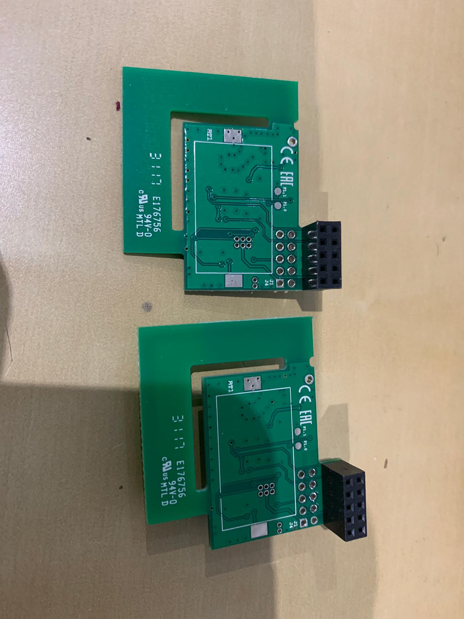

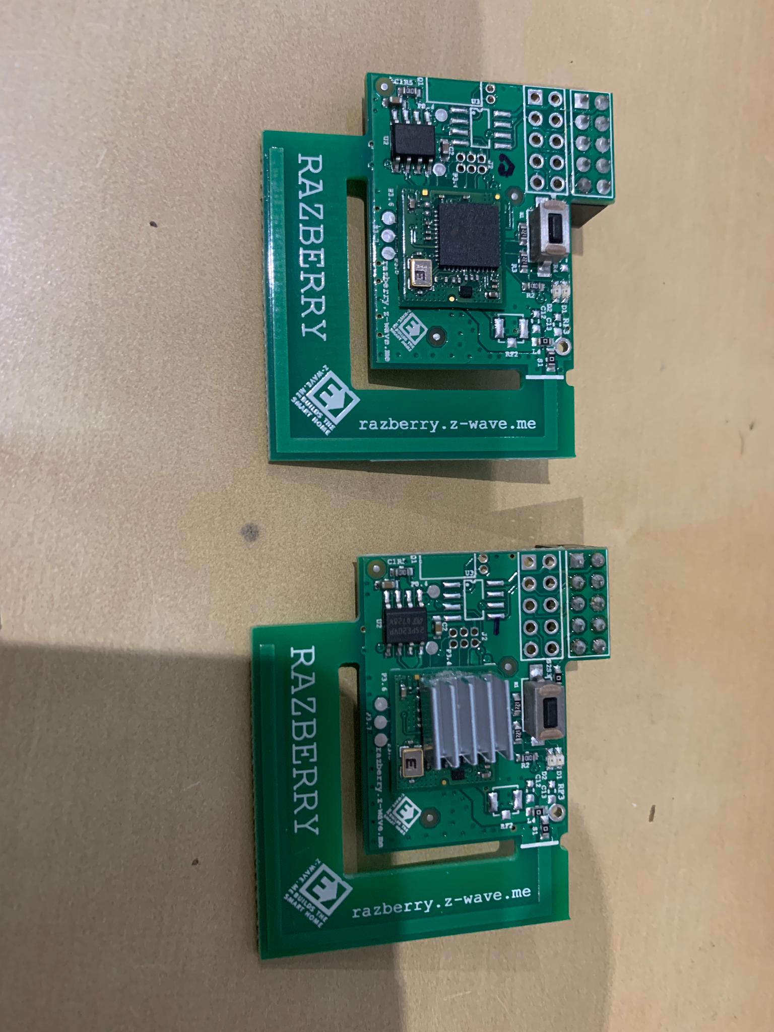

It seem a chip problem. I have changed to other RazBerry V2 and it is working.
It is curious that the Razberry that gives problems (the one on the right in the attached photos) brings a heatsink.
Re: 3.0.2 RaZberry Initialization Problem (Webserver.js:35:11)
Where have you taken it? There were never one with a heatsink!!! This is some DIY solution. Have you bought it in a shop of from some private customer as a second hand?
I bought at Amazon :evil:
Wow! As a new one? Blame your seller (please share the name with us if it is a shop, so we can also contact them).
A cooling system was never part of RaZberry - this is something hand made and you should return it to the seller as a second hand device
