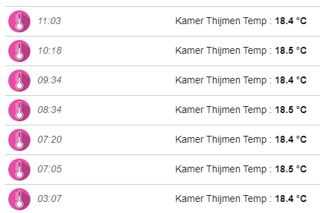

For logging purposes (InfluxDB/Grafana) , I want my fibaro FGMS-001 multisensor to report the temperature every 15 minutes, no matter if the temperature has changed or not.
I can do this by configuring parameter 64 to 900, which seem to wotk out fine.
however, when there is no change in temperature, I do see the device report it's value in the sniffer, but the Z-way gui events screen is not displaying this same value again, 15 minutes later.
It seems that z-way events screen is only displaying changes and is ignoring the same value reported again if it is unchanged.
As a result, I'm also not getting that value into node-red every 15 minutes when there is no change.
Expected behavior: Also display the event, even when there is no change.
I've attached two screenshots in which you can see that the same value is reported at 10:48 in the Zniffer, but there is no value vissible in the event monitor at 10:48 (because no change)
