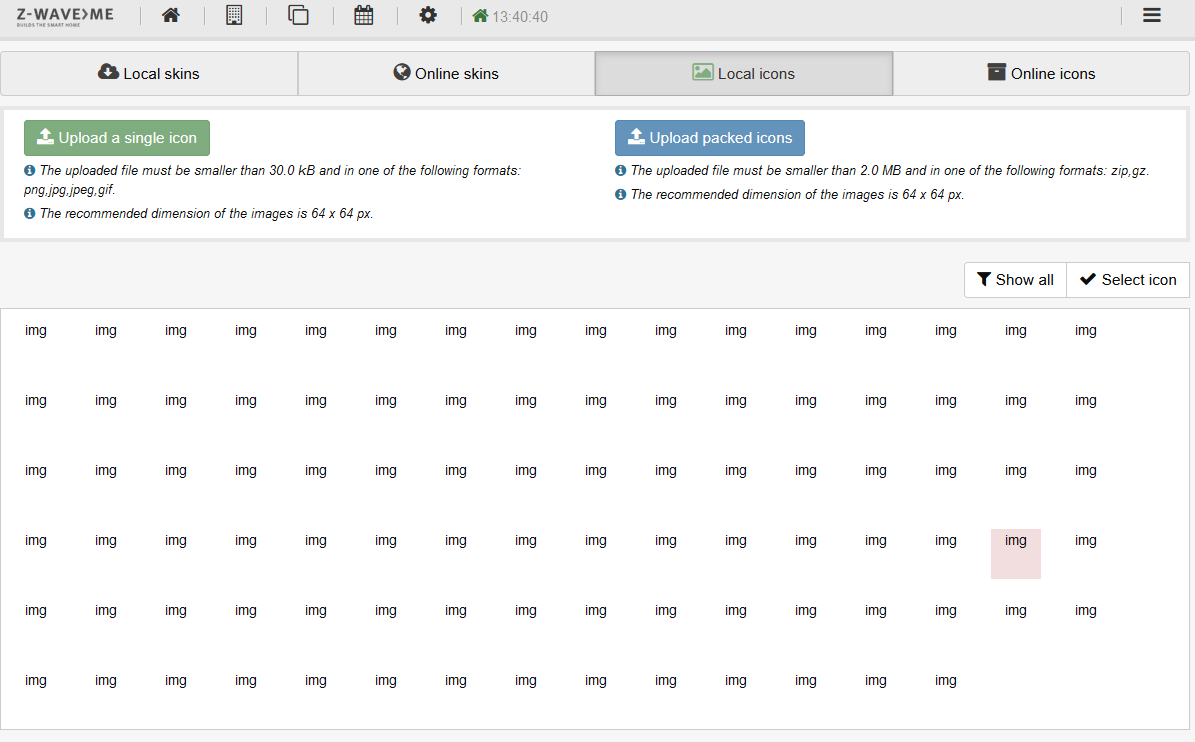

Does this bug cause missing local icons after fresh install? I think they are thone "New Smarthome-UI - Icons", which package is greyed and marked as installed. I attached screenshot.
Is it possible somehow to reload them?
