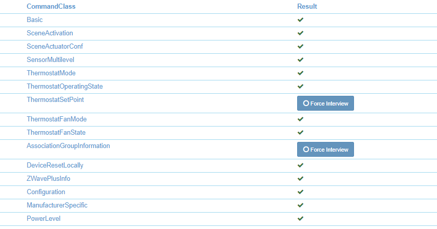

Hi Guys,
I have a problem adding GoControle thermostat GC-TBZ48L and alarm.com thermostat into my z-wave network. All the command classes pass the interview but ThermostatSetPoint!
Can you please help me resolve it!

Re: Interview errors for ThermostatSetPoint Command Class with both GoControl thermostat and alarm.com thermostat
Please show the low when you click on Force

This is the log:
Looks like the thermostat is not accepting more than two commands in MultiCommand.
You can bypass it globally by setting in config/Defaults.xml CommandClass MultiCmd -> MaxNum (requires Z-Way restart) to 2 or per device by doing /JS/Rub/zway.devices[14].MultCmd.data.maxNum=2 (works instantly). Then force interview

Hi PoltoS,
I so appreciate for you responce. I changed the config and restarted the zway, how ever the issue not fixed.
This is the new log:

This is also the log of another thermostat:
[2020-02-12 17:35:41.784] [zway] Adding job: ThermostatSetPoint Supported Get
[2020-02-12 17:35:41.784] [D] [zway] SENDING (cb 0x6c): ( 01 09 00 13 11 02 43 04 25 6C F8 )
[2020-02-12 17:35:41.786] [D] [zway] RECEIVED ACK
[2020-02-12 17:35:41.790] [D] [zway] RECEIVED: ( 01 04 01 13 01 E8 )
[2020-02-12 17:35:41.790] [D] [zway] SENT ACK
[2020-02-12 17:35:41.790] [D] [zway] Delivered to Z-Wave stack
[2020-02-12 17:35:41.805] [D] [zway] RECEIVED: ( 01 07 00 13 6C 00 00 02 85 )
[2020-02-12 17:35:41.805] [D] [zway] SENT ACK
[2020-02-12 17:35:41.805] [zway] Job 0x13 (ThermostatSetPoint Supported Get): Delivered
[2020-02-12 17:35:41.805] [D] [zway] SendData Response with callback 0x6c received: received by recipient
[2020-02-12 17:35:41.805] [D] [zway] SETDATA devices.17.data.lastSendInternal = **********
[2020-02-12 17:35:41.805] [D] [zway] SETDATA devices.17.data.lastSend = 119749 (0x0001d3c5)
[2020-02-12 17:35:41.805] [D] [zway] Job 0x13 (ThermostatSetPoint Supported Get): success
[2020-02-12 17:35:41.805] [zway] Waiting for job reply: ThermostatSetPoint Supported Get
[2020-02-12 17:35:41.864] [D] [zway] RECEIVED: ( 01 09 00 04 00 11 03 43 05 06 A0 )
[2020-02-12 17:35:41.864] [D] [zway] SENT ACK
[2020-02-12 17:35:41.865] [D] [zway] SETDATA devices.17.data.lastReceived = 0 (0x00000000)
[2020-02-12 17:35:41.865] [D] [zway] Received reply on job (ThermostatSetPoint Supported Get)
[2020-02-12 17:35:41.865] [D] [zway] SETDATA devices.17.instances.0.commandClasses.67.data.modemask = 6 (0x00000006)
[2020-02-12 17:35:41.865] [zway] Node 17:0 CC ThermostatSetPoint: Supported Thermostat SetPoint modemask 0x6
[2020-02-12 17:35:41.865] [zway] Adding job: ThermostatSetPoint Capability Get (v3)
[2020-02-12 17:35:41.865] [D] [zway] SENDING (cb 0x6d): ( 01 0A 00 13 11 03 43 09 01 25 6D F7 )
[2020-02-12 17:35:41.874] [D] [zway] RECEIVED ACK
[2020-02-12 17:35:41.875] [D] [zway] RECEIVED: ( 01 04 01 13 01 E8 )
[2020-02-12 17:35:41.875] [D] [zway] SENT ACK
[2020-02-12 17:35:41.875] [D] [zway] Delivered to Z-Wave stack
[2020-02-12 17:35:41.894] [D] [zway] RECEIVED: ( 01 07 00 13 6D 00 00 02 84 )
[2020-02-12 17:35:41.894] [D] [zway] SENT ACK
[2020-02-12 17:35:41.894] [zway] Job 0x13 (ThermostatSetPoint Capability Get (v3)): Delivered
[2020-02-12 17:35:41.894] [D] [zway] SendData Response with callback 0x6d received: received by recipient
[2020-02-12 17:35:41.894] [D] [zway] SETDATA devices.17.data.lastSendInternal = **********
[2020-02-12 17:35:41.894] [D] [zway] SETDATA devices.17.data.lastSend = 119758 (0x0001d3ce)
[2020-02-12 17:35:41.894] [D] [zway] Job 0x13 (ThermostatSetPoint Capability Get (v3)): success
[2020-02-12 17:35:41.894] [zway] Waiting for job reply: ThermostatSetPoint Capability Get (v3)
[2020-02-12 17:35:41.955] [D] [zway] RECEIVED: ( 01 0D 00 04 00 11 07 43 0A 01 2A 23 2A 5F D4 )
[2020-02-12 17:35:41.955] [D] [zway] SENT ACK
[2020-02-12 17:35:41.955] [D] [zway] SETDATA devices.17.data.lastReceived = 0 (0x00000000)
[2020-02-12 17:35:41.955] [E] [zway] Packet CC::THERMOSTAT_SETPOINT_CAPABILITIES_REPORT_V3 is too short: required at least 14 bytes, got 7
[2020-02-12 17:35:41.955] [E] [zway] Error returned from _zway_cc_call_handler(zway, command, controller->id, 0, data[4], &data[5]): Wrong packet from Z-Wave network or Discovery got bad data (stick communication failed) (-9)
[2020-02-12 17:35:43.968] [D] [zway] Job 0x13: deleted from queue
[2020-02-12 17:35:44.019] [W] [zway] Reply not received before timeout for job (ThermostatSetPoint Capability Get (v3))
[2020-02-12 17:35:44.019] [D] [zway] SENDING (cb 0x6e): ( 01 0A 00 13 11 03 43 09 02 25 6E F7 )
[2020-02-12 17:35:44.021] [D] [zway] RECEIVED ACK
[2020-02-12 17:35:44.025] [D] [zway] RECEIVED: ( 01 04 01 13 01 E8 )
[2020-02-12 17:35:44.025] [D] [zway] SENT ACK
[2020-02-12 17:35:44.025] [D] [zway] Delivered to Z-Wave stack
[2020-02-12 17:35:44.049] [D] [zway] RECEIVED: ( 01 07 00 13 6E 00 00 02 87 )
[2020-02-12 17:35:44.049] [D] [zway] SENT ACK
[2020-02-12 17:35:44.049] [zway] Job 0x13 (ThermostatSetPoint Capability Get (v3)): Delivered
[2020-02-12 17:35:44.049] [D] [zway] SendData Response with callback 0x6e received: received by recipient
[2020-02-12 17:35:44.049] [D] [zway] SETDATA devices.17.data.lastSendInternal = **********
[2020-02-12 17:35:44.049] [D] [zway] SETDATA devices.17.data.lastSend = 119971 (0x0001d4a3)
[2020-02-12 17:35:44.049] [D] [zway] Job 0x13 (ThermostatSetPoint Capability Get (v3)): success
[2020-02-12 17:35:44.049] [zway] Waiting for job reply: ThermostatSetPoint Capability Get (v3)
[2020-02-12 17:35:44.100] [D] [zway] RECEIVED: ( 01 0D 00 04 00 11 07 43 0A 02 2A 32 2A 5F C6 )
[2020-02-12 17:35:44.100] [D] [zway] SENT ACK
[2020-02-12 17:35:44.101] [D] [zway] SETDATA devices.17.data.lastReceived = 0 (0x00000000)
[2020-02-12 17:35:44.101] [E] [zway] Packet CC::THERMOSTAT_SETPOINT_CAPABILITIES_REPORT_V3 is too short: required at least 14 bytes, got 7
[2020-02-12 17:35:44.101] [E] [zway] Error returned from _zway_cc_call_handler(zway, command, controller->id, 0, data[4], &data[5]): Wrong packet from Z-Wave network or Discovery got bad data (stick communication failed) (-9)
[2020-02-12 17:35:46.172] [W] [zway] Reply not received before timeout for job (ThermostatSetPoint Capability Get (v3))
