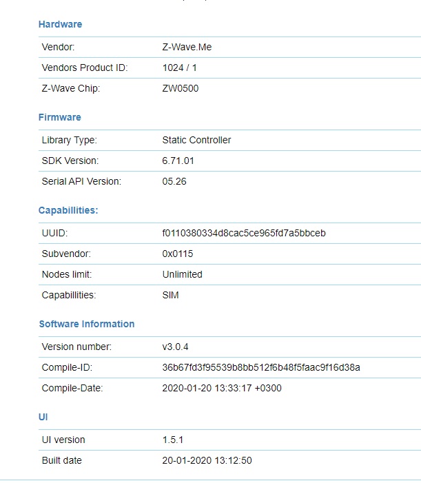

vinisz
Posts: 151
Joined: 23 Nov 2019 23:23
Re: Uzb fw versions?
Post by vinisz »
I'm confused about versions and everything, that "map" is not helping either.
I'm running this, Am I on a good/latest version for my UZB controller ?
