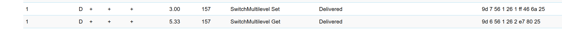

[2020-05-03 12:38:32.438] [zway] Job 0x13 (SwitchMultilevel Get): Delivered
[2020-05-03 12:38:32.438] [D] [zway] SendData Response with callback 0x37 received: received by recipient
[2020-05-03 12:38:32.438] [D] [zway] SETDATA devices.157.data.lastSendInternal = **********
[2020-05-03 12:38:32.438] [D] [zway] SETDATA devices.157.data.lastSend = 25470371 (0x0184a5a3)
2020-05-03 12_36_12-Z-Wave Expert UI - Firefox Developer Edition.png (11.72 KiB) Viewed 9641 times
Re: device stop responding
I see get and set delivered. But Get has not + on Reply - is it v3.0.x or older?
Sure devices are not secure? They also look not to support CRC16, but pakets are encapsulated - please do force interview - should fix it.
