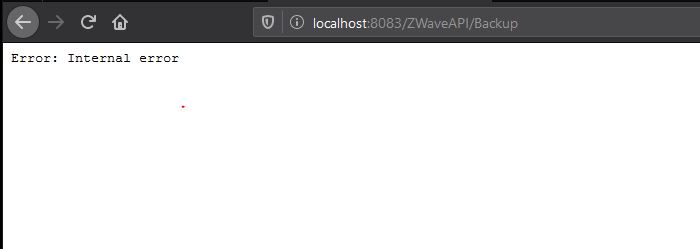

Installed 3.0.6 on Win10 OS.
Anyone got Controller Backup and Restore working?
I will not use a Z-Wave Controller in my system as long it does not support Backup function... I have UZB Stick but never got Backup working :(
So, meanwhile that might be fixed I use Aeotech Gen5 Z-Stick (with Domoticz) because Aeotech have at least Backup working for their Z-Stick.

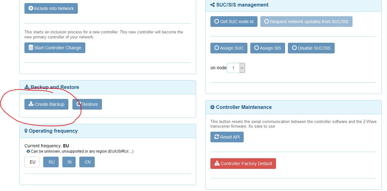

When trying to make a UZB Backup in Expert UI I get this error...

Re: Controller backup doesn't work - Windows OS
We will check it. Looks like some Windows specific issue.
Meanwhile you can save config/zddx/* - this is the what you need for restore.
We will check and fix it for next release.
As for the workaround, you can just copy one file. Go in Z-Way folder, then config/zddx and find the file with your home id. It contains all the data you need for expert UI

Hmm... I want to make an backup of the UZB Controller itself, is that data included in the "home ID file"?
Yes, it is

@Richard1:
Please try the new version: https://storage.z-wave.me/z-way-server/ ... v3.1.0.msi
Backup and restore should work in it.
