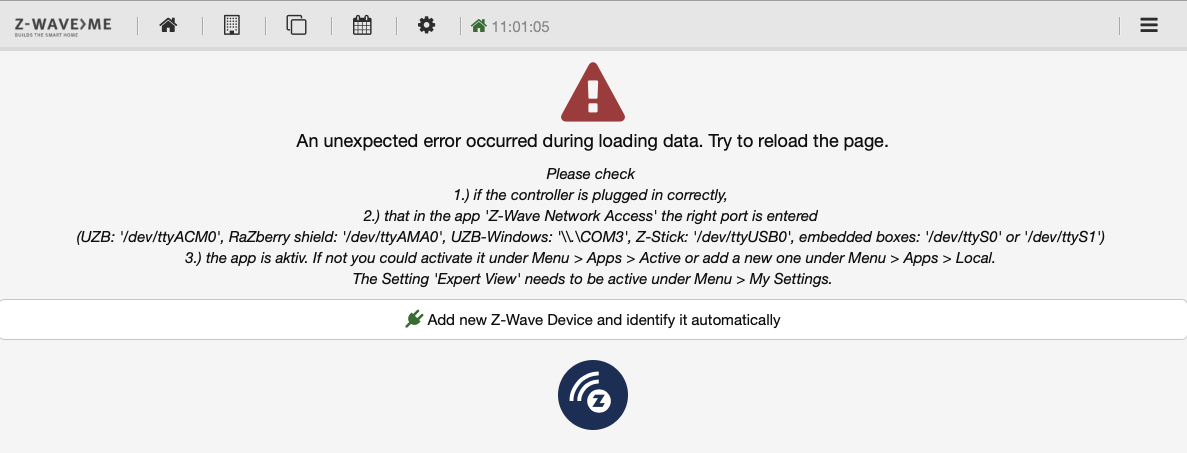

Another beginner problem, when trying to add my first Z-wave switch device, I get the error shown in the attached screen print from Mac OS, cannot figure out how to get rid of it, cannot add device with it there.

Re: Login Issue
Such error appears when you don't have Z-Wave hardware installed (UZB or RaZberry)
