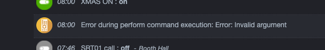

I have something similar with the same device (Secure SRT321) on the version (RaZberry 3.2.1)
Screenshot 2021-11-26 at 12.20.52.png (17.47 KiB) Viewed 9077 times
Here's the log ...
[2021-11-19 08:00:00.808] [D] [zway] SETDATA devices.2.instances.0.commandClasses.67.data.1.setVal = 20.000000
[2021-11-19 08:00:00.808] [I] [zway] Adding job: ThermostatSetPoint Set to node 2
[2021-11-19 08:00:00.808] [I] [zway] Adding job: ThermostatSetPoint Get to node 2
[2021-11-19 08:00:00.809] [I] [zway] Node 2:0 CC ThermostatMode: Thermostat Mode 1 is not supported by device (modemask 0x0)
[2021-11-19 08:00:00.811] [I] [core] Notification: error (module): Error during perform command execution: Error: Invalid argument
[2021-11-19 08:00:00.819] [I] [core] Error: Invalid argument

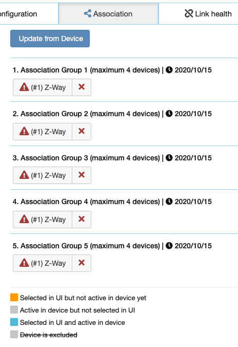

Also, what's the meaning of the warning triangles here ...
Screenshot 2021-11-26 at 12.25.05.png (64.42 KiB) Viewed 9077 times
Again, it seems to work despite these.
Re: Invalid argument error when changing thermostat value
You need to force the interview of the thermostat. The thermostat reports no modes, so Z-Way is upset.
Ignore the triangles.

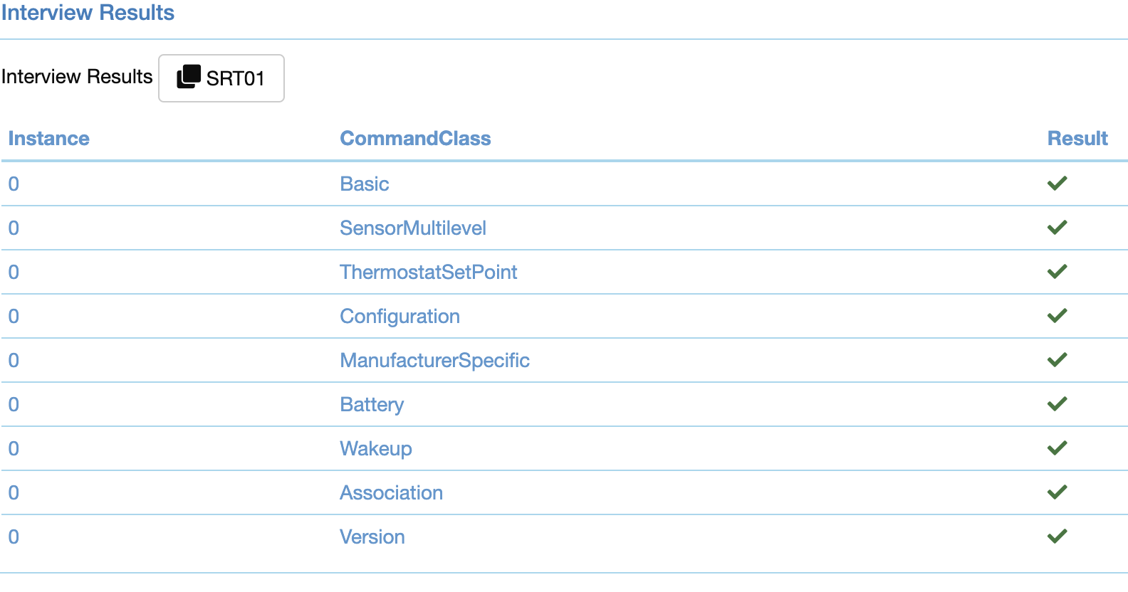

There was already a complete interview in place ...
Screenshot 2021-11-26 at 14.57.59.png (96.25 KiB) Viewed 9067 times
But, for you, I forced another interview (the wake-up required toggling switch 1 in the SRT321), and another interview completed without error.

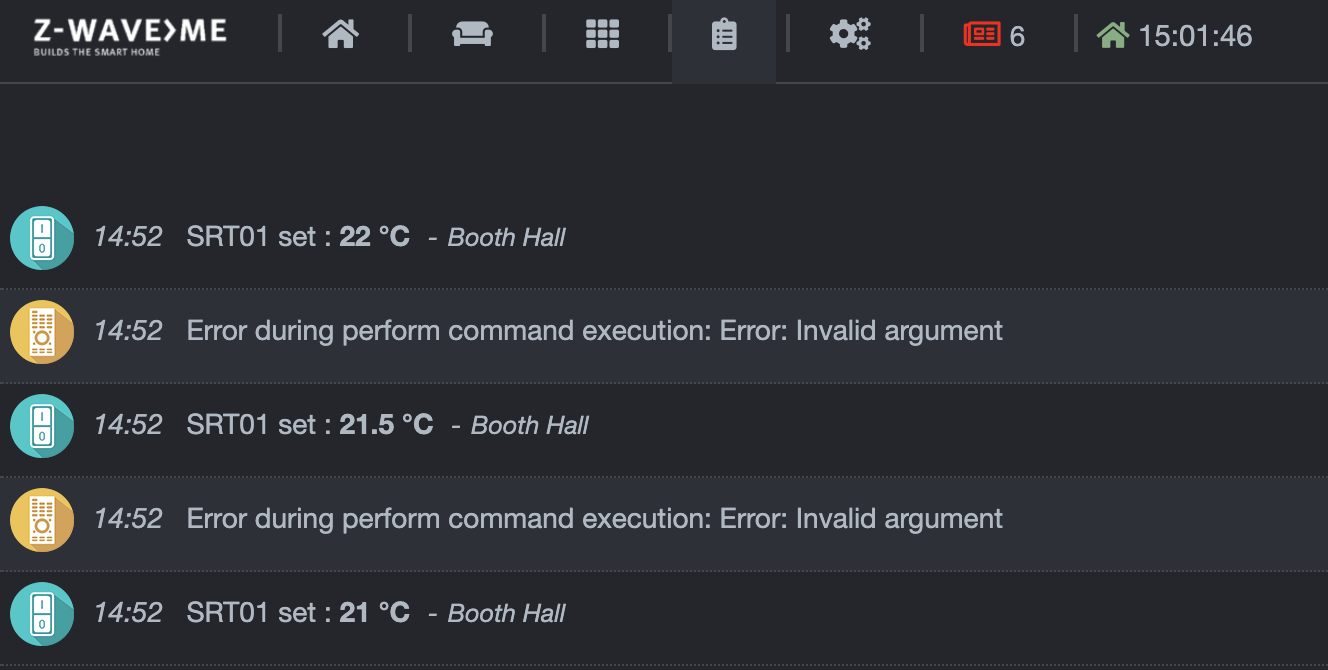

However, when I set the temperature in the Smart Home UI, I still get the same errors in logs ...
Screenshot 2021-11-26 at 15.01.46.png (123.76 KiB) Viewed 9067 times
[2021-11-26 14:52:12.846] [E] [HTTP] Callback execution error: TypeError: Cannot read property 'meta' of undefined
