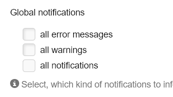

Another optical problem, when im checking some checkboxes in the options, i dont see the cross symbol.
for example: one of the boxes is checked, they look slightly different even without the cross, like in the picture attached

I also have problems with rendering marks at 3.1.0 @ latest Chrome
2020-09-04 14_58_32-Z-Wave Smart Home.png (7.08 KiB) Viewed 13868 times
IE11 shows marks correctly

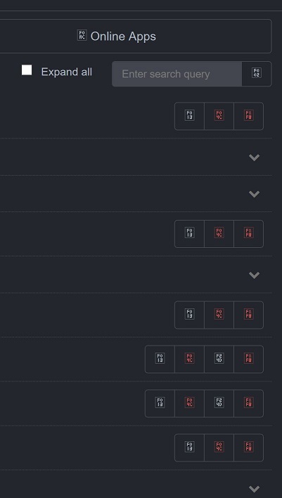

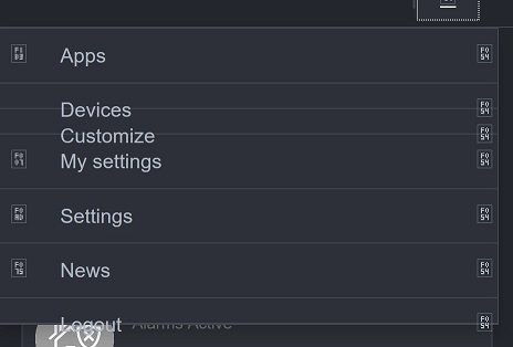

For me the icons gone missing from the "desktop" UI version.
Update: generically the skins are really messed up
Re: 3.1.0 minor problems with some apps
You are right, we have updated icons and skins were not revised. We will make that asap
Indeed, check boxes looks to have issues. Will check it.

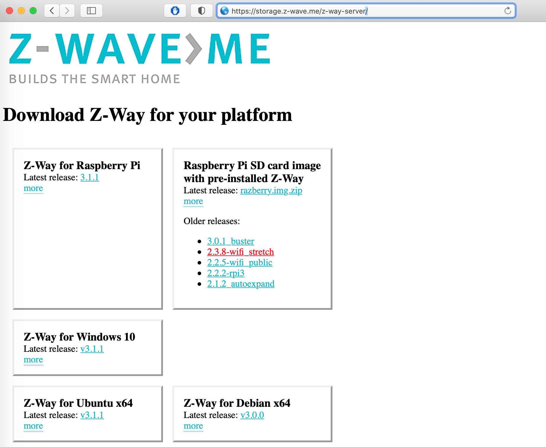

I cant find the old 2.3.8 firmware anymore. Does someone have a link to the image?
I need to revert back, the wife acceptance factor is at 0. Hue app and trap events from remotes and sensors do no work anymore and that means i cant use half of the lights in my house.
aivs
Posts: 68
Joined: 04 Mar 2011 15:26
Post by aivs »
https://storage.z-wave.me/z-way-server/ ... ch.img.zip
