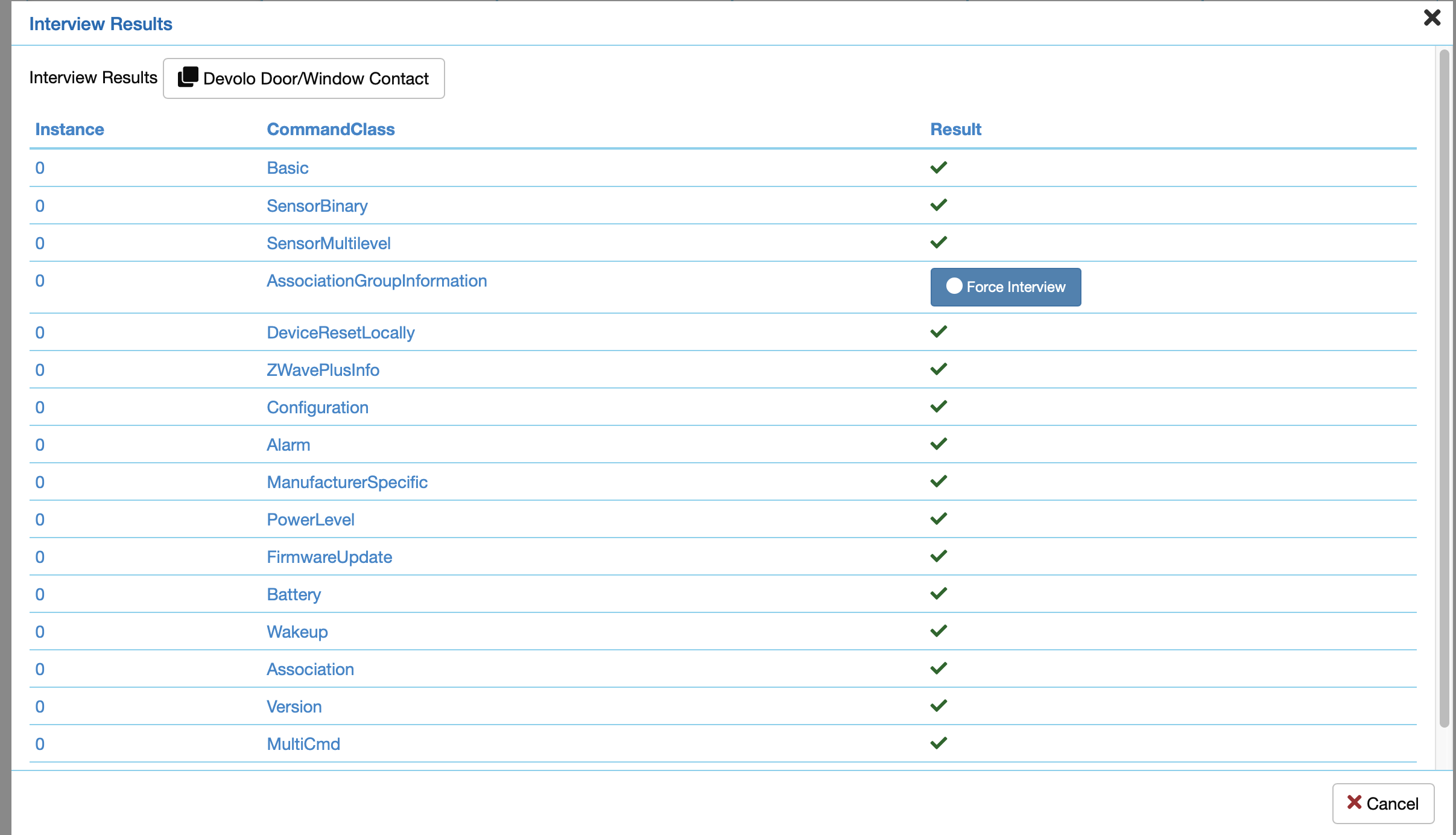

I excluded the device an I tried to include the device #35 again, servers times. The interview is not completed.

"IP-ADDRESS":8083/JS/Run/zway.devices[X].AssociatonGroupInformation.interviewDone=true
may help you, otherwise search in the forum for "interviewDone"

I think i found the problem. It seems the device was inventoried twice. I saw this at the expert GUI. This was not visible in the normal GUI. I will add new device in the Expert GUI only next time.
