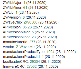

Current version:
APIVersion: 05.23 (12:28)
APIVersionMajor: 5 (12:28)
APIVersionMinor: 23 (12:28)
manufacturerId: 277 (12:28)
vendor: Z-Wave.Me (12:28)
bootloaderCRC: 29304 (12:28)
firmwareCRC: 52559 (12:28)

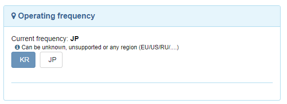

Only KR and JP frequencies available!! I'm in Europe!! I had EU freqs before, no idea how I reached this point :-(

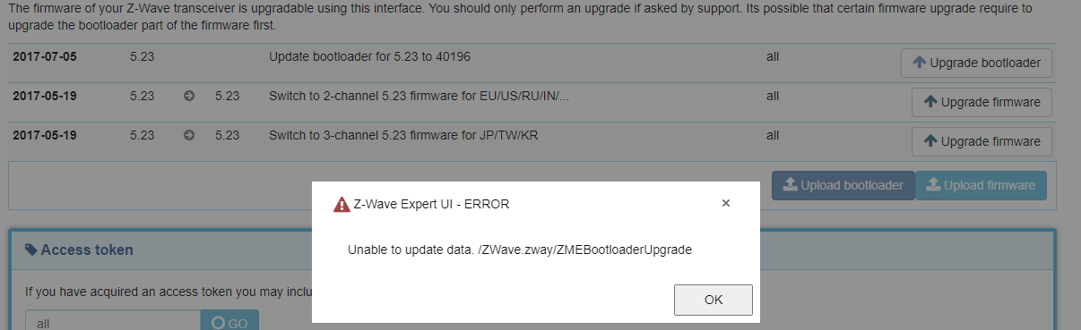

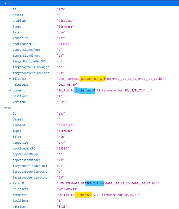

In the Expert GUI I see "Update bootloader for 5.23 to 40196" option but it fails.

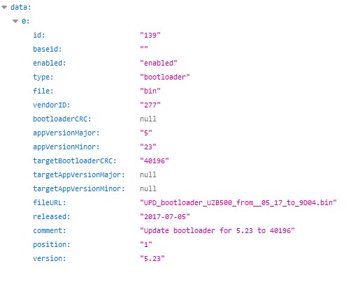

wget https://service.z-wave.me/expertui/uzb/UPD_bootloader_UZB500_from__05_17_to_9D04.bin
./ZMESerialUpdater serialapi_uzbupdate -d /dev/ttyACM0 -b UPD_bootloader_UZB500_from__05_17_to_9D04.bin

Please enter token "all" and use "Update bootloader for 5.23 to 40196", then "Update from 5.23 to 5.27 firmware for EU/US/RU/IN/CN/ANZ/BR"

And go to Controller Info -> Debug. Then all frequencies will be listed.

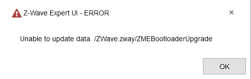

- Update bootloader ("Update bootloader for 5.23 to 40196") through GUI gives an error:
I'm on a RPi with the latest razberry.img.zip on it
Taking a look at "/var/log/z-way-server.log" when popup appears it shows a message about wrong checksum:

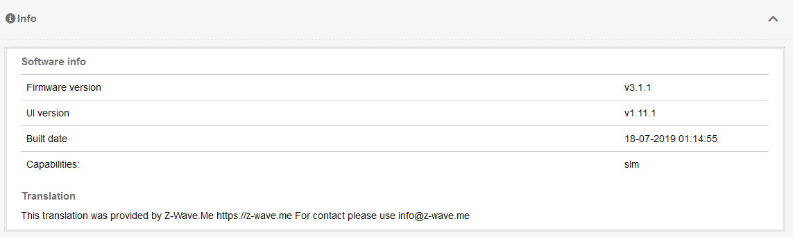

Upgrade to v3.1.1 first, please

I downloaded yesterday the https://razberry.z-wave.me/z-way-server ... ry.img.zip image and I thought it was already the 3.1.1.
Now you've said that, I've seen into the GUI it is 3.0.1 + 1.10.1 so I thought maybe running a "apt-get update && apt-get upgrade" could do the trick but it doesn't:

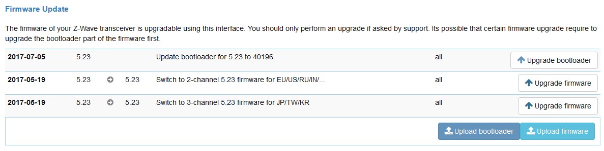

It has been updated to 3.1.1 (RPi has been restarted after that):
Edited (yesterday no upgrade options appear in the GUI but today they appear again). Unfortunately the upgrade didn't do the trick because same error appear:
The controller info:
No chance to modify the frequency to the EU one on its current dongle status:
Any further idea of what can I do or what could be happening?
Really appreciate your support

Now I have bootloader CRC = 29304 = 7278 so I know what I must perform is (https://forum.z-wave.me/viewtopic.php?p=86933#p86933)
1) upgrade bootloader to 40196: UPD_bootloader_UZB500_from__05_17_to_9D04.bin
2) upgrade firmware to 5.27: UPD_FIRMWARE_UZB_STATIC_2ch_ZME_05_17_04000001_ZME_05_1b_04000001.bin
3) upgrade firmware to 5.36: UPD_FIRMWARE_UZB_STATIC_2ch_ZME_05_1b_04000001_ZME_05_24_04000001.bin
But step 1 isn't working at all (RPi + latest zway server 3.1.1 as suggested by PoltoS) due to the "Wrong checksum" error.
