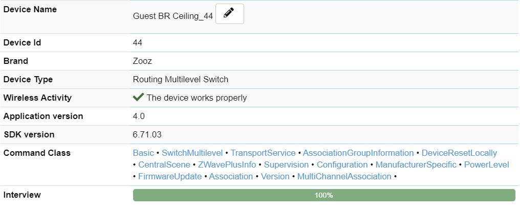

What version of Z-Way software are you using and what version of firmware is the Zooz switch using?
I use Zooz switches and have not encountered a problem changing parameter values (and have successfully updated the firmware in the Zooz switches - having a direct route between the Zooz switch and Z-Way controller makes the firmware update go much faster).
Have you tried the Expert Commands tab? Scroll down until you see the Configuration command class. Do a Get for parameter 9, and then do a Set for parameter 9 with the value 0. If there's still a problem, you should be able to see what Z-Way is sending and receiving to the device using the Analytics->Zniffer History tool. Additional details are available from the command line (in file /var/log/z-way-server.log and directory /opt/z-way-server/automation/storage).
I've included a screenshot of one of my Zooz switches so that you can see the firmware info and supported command classes. Note that I typically use insure inclusion to reduce traffic and improve response time (for devices that don't need security).
Zooz_deviceID 44.JPG (60.12 KiB) Viewed 12248 times

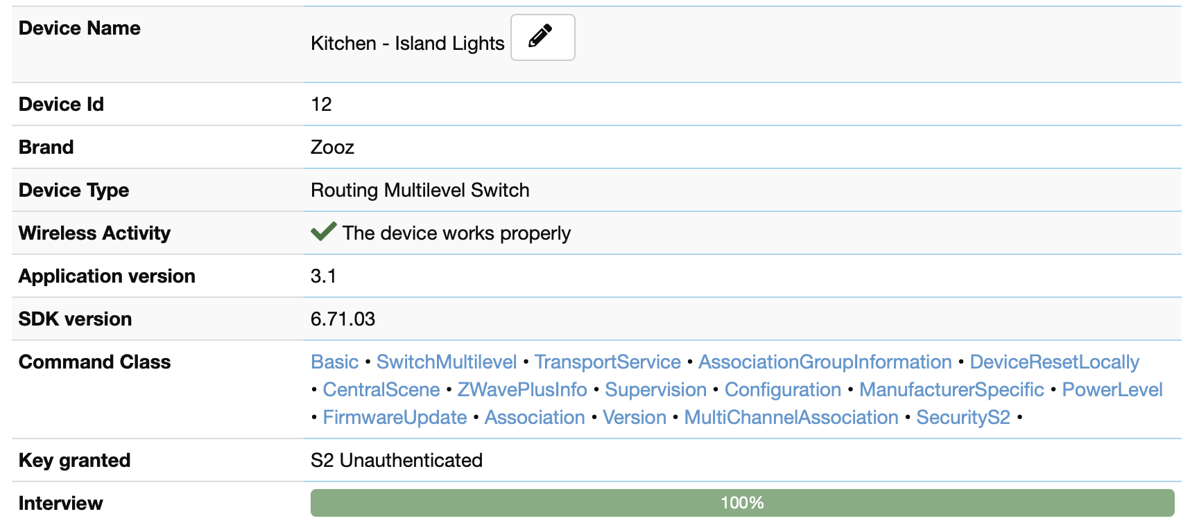

Here's a screenshot of my ZEN27 switch.
It looks similar to yours but my Application version shows 3.1 and yours shows 4.0. Also, yours doesn't show S2 Authentication?
I've actually been able to set the parameter to anything between 1 and 99 but 0 doesn't appear to work.

I see this line in the log:
[2020-12-17 14:01:08.190] [W] [zway] Node 12:0 CC Supervision: Setter was failed by the recipient: Configuration Set

Re: Device doesn't have necessary service to change parameters? (manufacturer says it should)
This means device has rejected the value. Please show this to Zooz. They are very responsive.
