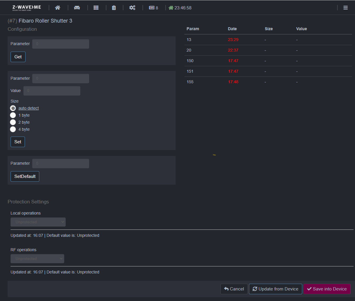

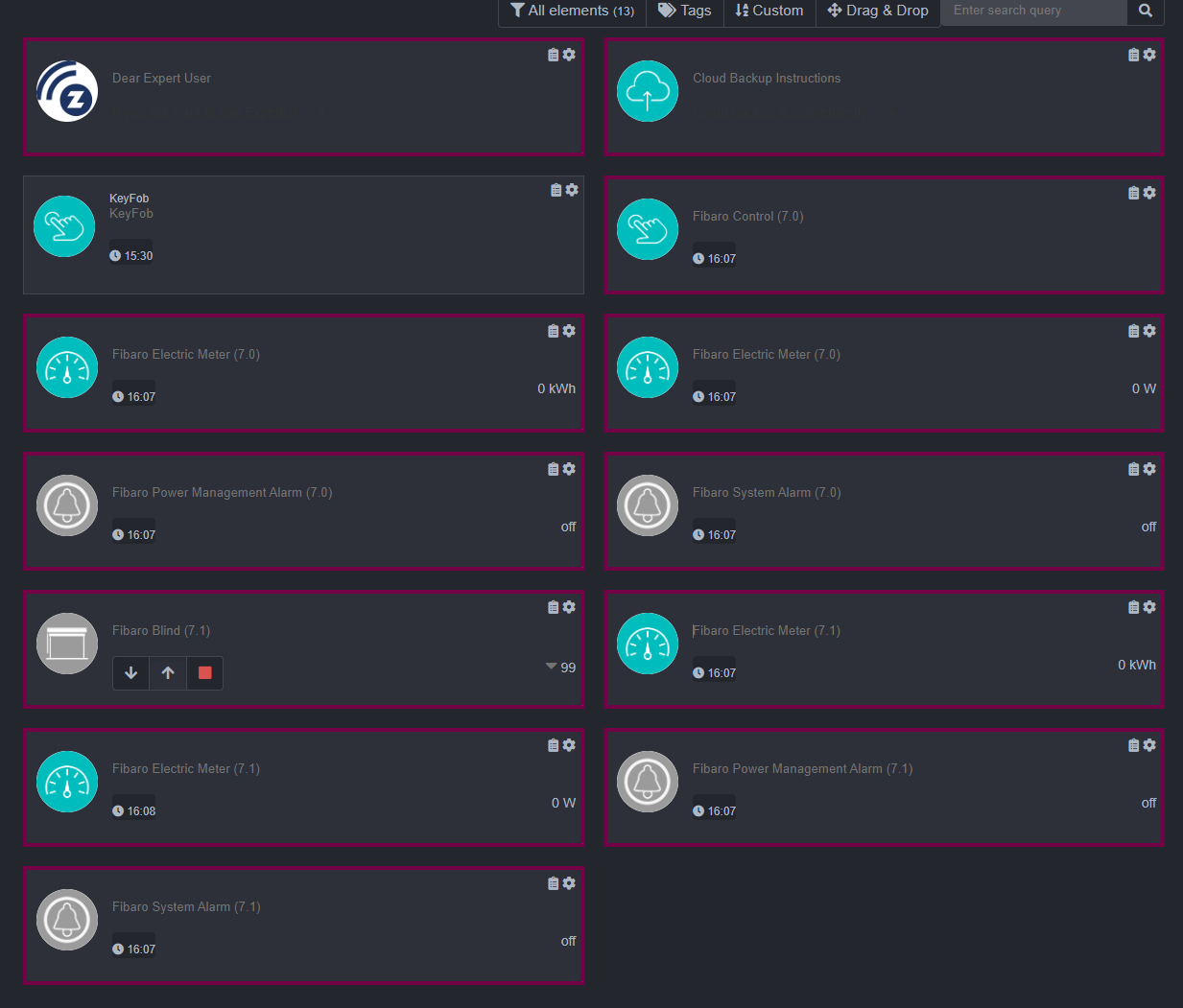

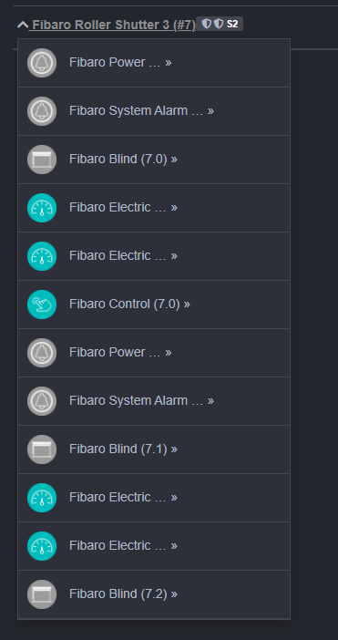

So I've already read many threads about FGR-223 EU v5.1 (which is the one I have) but not of them fits my problem.
I was able to secure include (using 5 digit pin from device back) this into my razberry. However, what I see and what I can do .. I don't understand. I am new to Zway, but I don't know if what I see is right or wrong. Please have a look at attached screenshot..
I also tried to get parameters, but they keep coming back empty (-).
The controls on 7.1 work sometimes, but just once..

Re: Fibaro Roller Shutter 3 ..again..
You can let us check it via remote support. Please write on support@z-wave.me with your credentials (you can create a new temp user)
