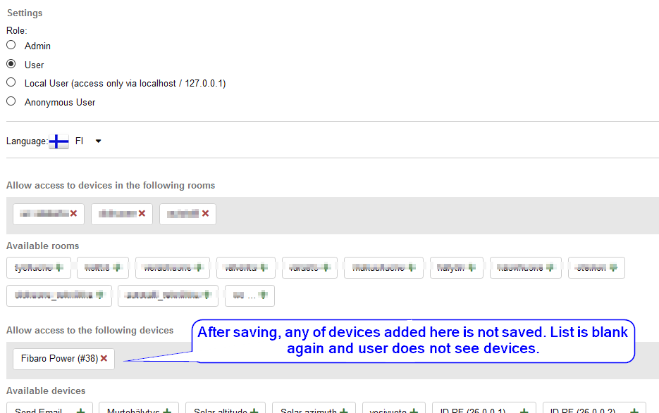

Hi all,
I can't allow user access to certain devices, or I just don't understand how it shoud be done.
I have created new user with role User.
I have allowed certain rooms for that user. This is working, user seems devices on that room.
But is it possible to add only devices, which are not in any room?
If I add access to device and press save (in screen capture from user settings), after opening user again, added devices are not saved.
Is it so that it is not possible or I just don't understand something?
Version 3.1.1 in raspian here.
Raspi 4(Buster), Zwave Version 4.0.2 (7.28), Raz 7 Pro
Re: Limit user access to certain devices not working?
Should work. We will check it on our side.
In your case the device added is not in any room?

Post by z-wavettaja »
Yes, in my case device added is not in any room. But I also tryed now to add device, which is in room, where user does have access. Still not saving.
Please first check it on v3.1.2 and if same, please provide log (if you see an error on save) and if no errors, please provide us access to check it.
I find out that problem was only in one user. I re-created that and now it is working as expected. So some kind of corrpution in user profile maybe?
Thanks for your attention. :D
