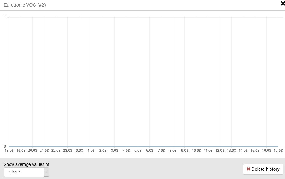

But VOC range is in ppm (parts per million), same as by device calculated CO2 value.

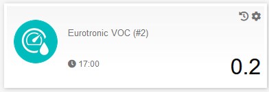

So VOC value will be in most cases between 0.05 and 0.2 - sometimes up to 0.4
The UI element will show only one sign after 0 - most time will be 0.1.
At sensor chart we will see nothing - only a line (because of integer values here).
Z-Way chart of the VOC sensor

UI VOC sensor
UI VOC sensor

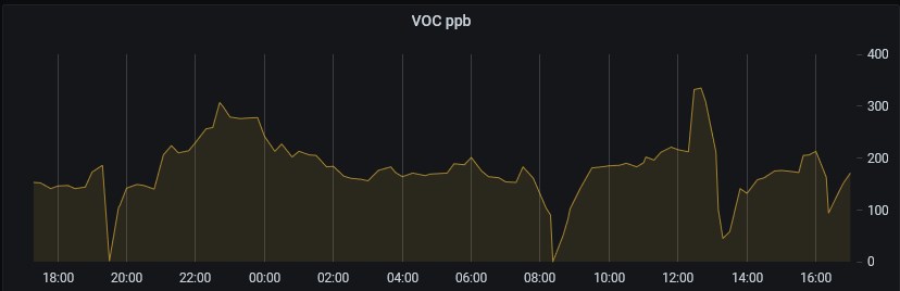

This are the real values in chart in ppb:
real chart of VOC sensor
