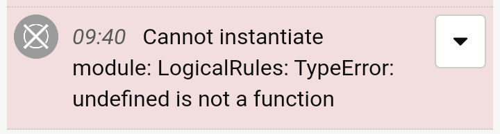

It would be handy, if you could see, which device or rule caused a specific error.
For example, I have the following error:
I cannot find out which logical rule is affected, other than checking each rule for possible issues.

It seems the eror origins from this:
[2021-02-04 22:29:04.826] [I] [core] Instantiating module 104 from class LogicalRules
[2021-02-04 22:29:04.826] [I] [core] --- Starting module Logical Rule
[2021-02-04 22:29:04.853] [I] [core] (node) warning: possible EventEmitter memory leak detected. %d listeners added. Use emitter.setMaxListeners() to increase limit. 11
[2021-02-04 22:29:04.854] [I] [core] Notification: error (core): Cannot instantiate module: LogicalRules: TypeError: undefined is not a function
[2021-02-04 22:29:04.860] [I] [core] TypeError: undefined is not a function
    at EventEmitter.on [as addListener] (automation/lib/eventemitter2.js:392:29)
    at _.extend.on (automation/classes/DevicesCollection.js:200:37)
    at LogicalRules.attachDetach (automation/userModules/LogicalRules/index.js:132:28)
    at automation/userModules/LogicalRules/index.js:44:9
    at Array.forEach (native)
    at LogicalRules.init (automation/userModules/LogicalRules/index.js:42:20)
    at AutomationController.instantiateModule (automation/classes/AutomationController.js:483:13)
    at AutomationController.<anonymous> (automation/classes/AutomationController.js:590:12)
    at AutomationController.loadModule (automation/classes/AutomationController.js:589:5)
It seems to be a problem in logical rule ID 104, but I have no idea what the problem is :?

Re: [Request] More information on errors
The problem looks to be in the line above:
[2021-02-04 22:29:04.853] [core] (node) warning: possible EventEmitter memory leak detected. %d listeners added. Use emitter.setMaxListeners() to increase limit. 11
You have subscribed too many times on the same event. It complains on this. You can rise the limit in libs/EventEmitter.js
