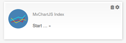

Bildschirmfoto vom 2021-02-07 13-27-51.png (10.99 KiB) Viewed 123812 times
Create a new instance of module Information Widget and enter following configuration (with some blanks after Start):
    moduleId: "InfoWidget",
    active: true,
    title: "MxChartJS Index",
    params: {
        widgets: [
                headline: "MxChartJS Index",
                text: "Start
                <script>
                    //target = '_parent';        //open in same window
                    target = '_blank';         //open in new window
                    window.open('user/MxChartJS/index.html', target);
                </script>",
                imgURI: "/ZAutomation/api/v1/load/modulemedia/MxChartJS/icon.png",
        internationalize: false
    creationTime: "2021-02-07 13:23:54",
    category: "device_enhancements",
Wih same method it's possible to call also other webpages like MxInfo Index or whathever you want.

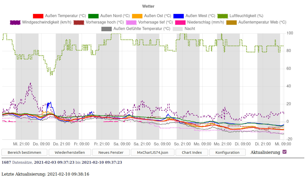

Re: MxChartJS tip: conditional coloring the background
Post by piet66 »
Although it is not intended, with an additional entry you can colorize the background:
    index: 12,
    device: "Daylight_35 (Tageslicht)",
    metric: "level",
    formula: "x == 'off' ? 100 : null",
    devlabel: "Nacht",
    color: "#cccccc",
    graphType: "rectangle",
    lineType: "invisible",
    fill: 98,
    intcharticon: false

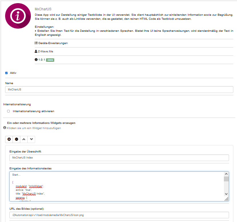

Hello, could someone help me getting than to work?. I have created a Infomation Widget with the App "Infomation Widget". But where i have to copy the code ? Regards Max
Ok, I figured it out.
It was easier then i thought.
