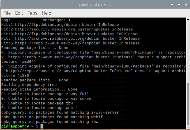

Has anyone ever installed z-way on virtual vm?
I managed to go as far as just installing the latest "Raspberry Pi Desktop" from https://www.raspberrypi.org/software/ra ... i-desktop/
After that run recommended "wget -q -O - hp://razberry.z-wave.me/install | sudo bash"
It did some dowloadings but at the end complained that:
no packages.png (217.96 KiB) Viewed 10285 times
Any ideas what is going on?
Re: VMware and Z-wave
This is because of the architecture type. We support raspbian for ARM only.
You can use either Ubuntu/Debian x64 or Raspbian on Raspberry Pi
