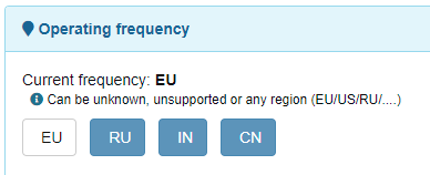

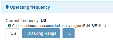

Screenshot 2023-11-20 at 2.05.54 AM.png (12.99 KiB) Viewed 26861 times
to
Screenshot 2023-11-20 at 2.12.06 AM.png (13.81 KiB) Viewed 26861 times

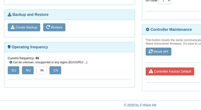

Re: UZB frequency
Turning Debug mode on the Network > Controller Info tab would allow to see all buttons for the frequency change. By default only similar frequencies are show to prevent people trying US on a EU antenna and vice versa
