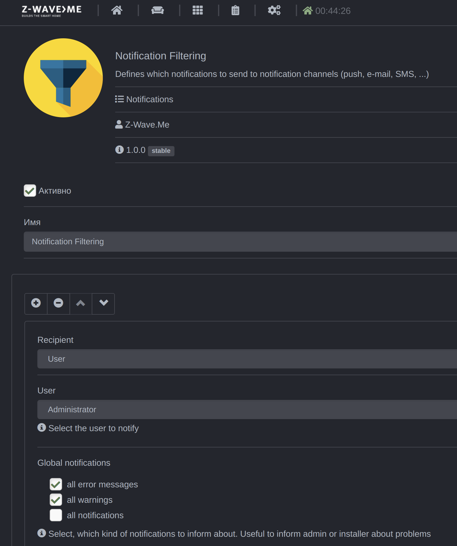

First, it is worth to fix the issue!
Second, you can turn off error messages here in NotificationFiltering app (it is sometimes very slow to load the UI!)
Z-Way NotificationFiltering app
