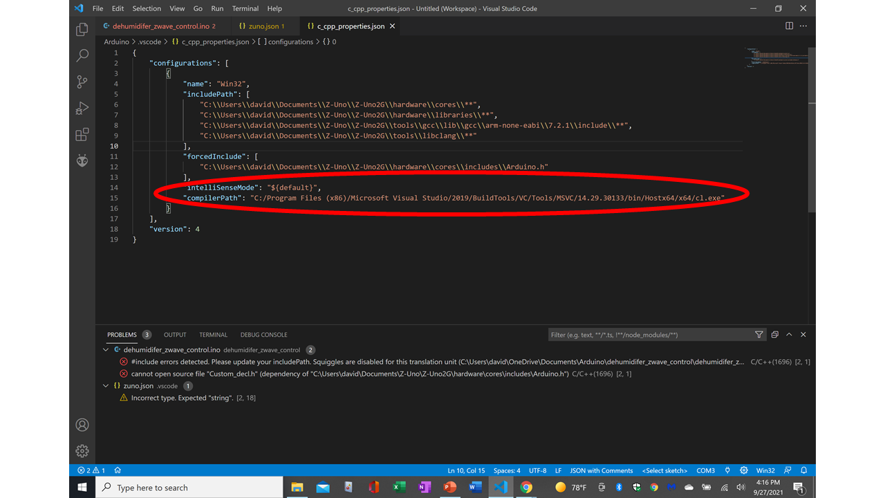

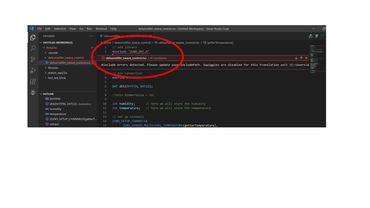

I've included two screenshots. One is of the intellisense problems. But this is minor and related to syntax suggestions.
The other screenshot is of the compiler that the ZUno extension is using. This is a MSFT Win32 compiler and it DOES seem to work. The Adrduino IDE uses a GCC variant (I think) and it made sense to me that VS Code would also use a GCC variant but I have been unable to locate a good GCC compiler to use. I am not sure that I need GCC at this point...

"One is of the intellisense problems. But this is minor and related to syntax suggestions." - As for me, this is just one of the significant advantages of vs code.
"This is a MSFT Win32 compiler and it DOES seem to work" - Actually gcc is used))
Why is the settings so awkward? - a not very good solution seems to have been chosen with the addition of settings for zuno to intellisense - now an additional setting named "Zuno" is added - I think this is a better solution. Update - now those problems shouldn't be.
