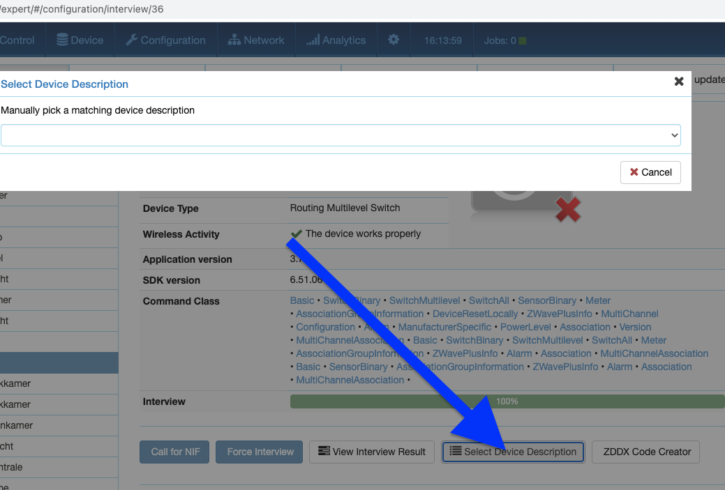

Error: Failed to get a list of products. Check index file.
Post by RPJacobs »
expert/#/configuration/interview/36
"Select Device Description"
ZWave.zway/Run/devices[36].GuessXML() does not load.
Z-way version v3.2.1
Screenshot 2021-10-19 at 17.14.13.png (137.31 KiB) Viewed 9679 times
Re: Error: Failed to get a list of products. Check index file.
This is a bug in the latest release. Please try z-way-3.2.1-3-g485f14e9_armhf.deb or go in /opt/z-way-server/ZDDX and do ./UpdateXML.sh
RPJacobs
Posts: 18
Joined: 23 Mar 2017 11:41
Post by RPJacobs »
./UpdateXMLs.sh works for me. Thanks!
