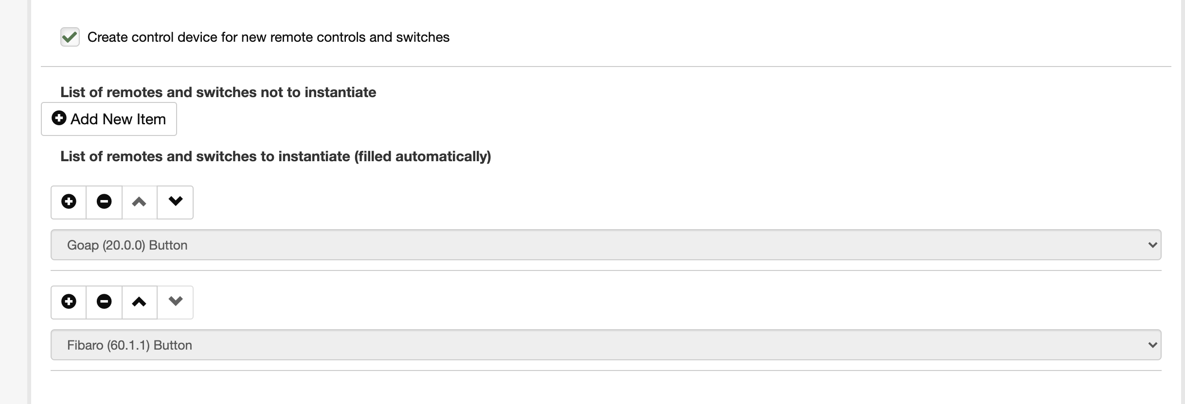

But not in the Trap events from Remotes and Sensors
Screenshot 2021-10-20 at 16.38.23.png (106.96 KiB) Viewed 12856 times
Please tell me what i'm doing wrong....
Re: 3.2.1 | Qubino Flush Dimmer | Sensor Binary Report | Trap events not working
Trap events from buttons is for Basic Set/Central Scene. For Sensor Binary search for another device with ID containing -40-x-39-x

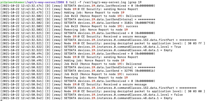

Just created a test setup and did a tail on the log-file | grep 19 (19 is the device ID) L2 on and off
Screenshot 2021-10-22 at 12.43.11.png (135.22 KiB) Viewed 12816 times

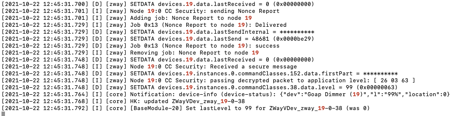

L1 ON
Screenshot 2021-10-22 at 12.45.59.png (80.33 KiB) Viewed 12816 times
Looks like the device 19-0-48-1 is hidden or disabled. Go in Menu > Devices > Z-Wave > Management > Device 19 and enable sensors

No it's not disabled, it is never created... so i can see it in expert mode but it's never created as a device.
Okey, got it. Check for postfix in the expert UI (enable debug mode in Controller info and then go to device configuration tab and see Postfix). It should have noVdev-0-48-1
