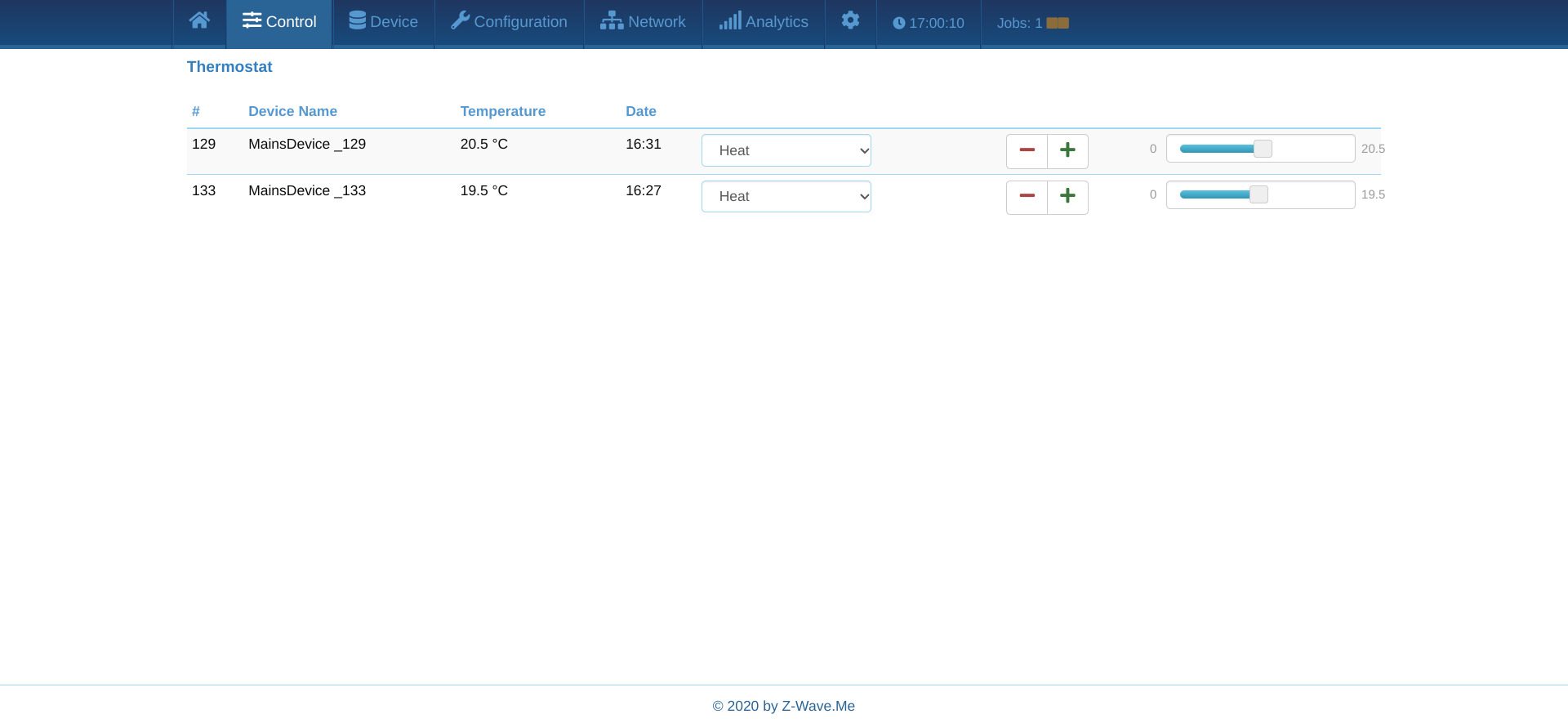

otverber
Posts: 78
Joined: 28 Mar 2018 20:17
Re: Namron Thermostate plug - Halts on ThermostatSetPoint
Post by otverber »
remote access should be okay now?

Posts: 7650
The device is buggy - it never replies to ThermostatSetPoint Get(mode=15). You can heal it like this:
https://find.z-wave.me/JS/Run/zway.devi ... int.Get(1)
This is a hack, but it works.
You can send this to the manufacturer in order to help them fix it:
[2021-12-11 23:36:28.406] [zway] Adding job: Security S2 Encapsulation (S2 Unauthenticated), ThermostatSetPoint Get to node 129
[2021-12-11 23:36:28.417] [D] [zway] SENDING (cb 0x3a): ( 01 16 00 13 81 0F 9F 03 55 00 04 85 13 63 9B 89 96 34 E4 78 22 25 3A 5D )
[2021-12-11 23:36:28.417] [D] [zway] Secure payload: ( 43 02 0F )
[2021-12-11 23:36:28.558] [zway] Waiting for job reply: ThermostatSetPoint Get from node 129
[2021-12-11 23:36:28.558] [zway] Job 0x13 (Security S2 Encapsulation (S2 Unauthenticated), ThermostatSetPoint Get to node 129): Delivered
[2021-12-11 23:36:30.693] [W] [zway] Reply not received before timeout for job (ThermostatSetPoint Get to node 129)
