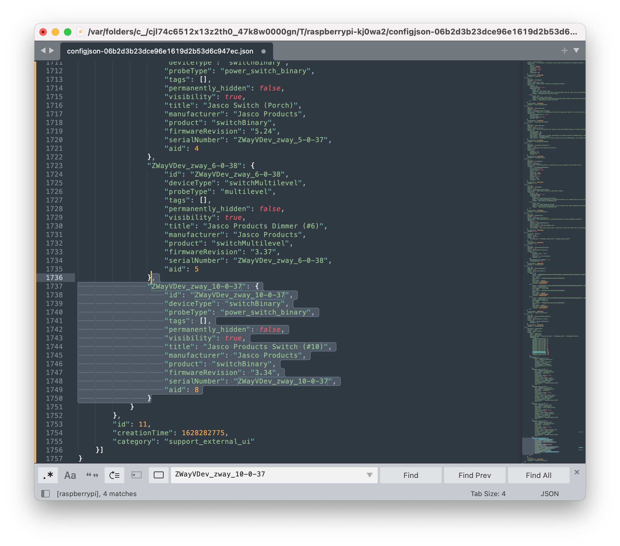

Thanks for the reply, but the Home app does not show any of the usual details for the device that the OP and I had error out while re-adding the hub. I'm assuming it is device #10, but Is there another location to verify the device ID since it doesn't show up on the GUI anymore?
I was able to see the details for the other 4 "deleted" devices and followed your steps to successfully remove them. However, unless the status of the HomeKit Gate app was not correct, it has been active the whole time -- before and after the upgrade. I wish I could recall the exact events for these devices, but most of them may have been unplugged during the upgrade. I know one was still plugged-in to control my Christmas tree, but had issues previously with these GE/Jasco Lamp Modules sometimes showing up as unsupported in the Home app despite working correctly before.
