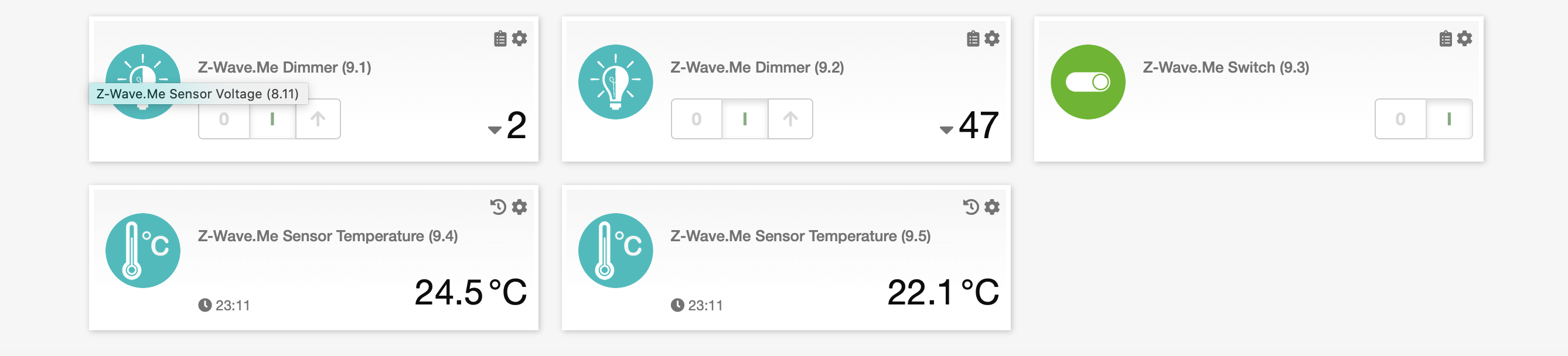

have tried and your code works with my Razberry gateway the right way, I just add loop() and some code to see that the sketch works:
ZUNO_ENABLE(WITH_CC_SWITCH_MULTILEVEL WITH_CC_METER WITH_CC_SENSOR_BINARY WITH_CC_SWITCH_COLOR WITH_CC_SENSOR_MULTILEVEL WITH_CC_DOORLOCK WITH_CC_SWITCH_BINARY WITH_CC_NOTIFICATION WITH_CC_THERMOSTAT);
ZUNO_DYNAMIC_CHANNELS(32);
void setup() {
  ZUNO_START_CONFIG();
  // Channel 1 - Switch multilevel
  ZUNO_SET_ZWCHANNEL(0x81);
  ZUNO_ADD_CHANNEL(2,0,0);
  // Channel 2 - Switch multilevel
  ZUNO_SET_ZWCHANNEL(2);
  // Channel 3 - Switch binary
  ZUNO_SET_ZWCHANNEL(3);
  ZUNO_ADD_CHANNEL(1,0,0);
  // Channel 4 - Thermometer
  ZUNO_SET_ZWCHANNEL(4);
  ZUNO_ADD_CHANNEL(4,1,66);
  // Channel 5 - Thermometer
  ZUNO_SET_ZWCHANNEL(5);
  ZUNO_COMMIT_CONFIG();
  pinMode(13, OUTPUT);
  pinMode(14, OUTPUT);
  pinMode(15, OUTPUT);
  // Start dimmers values
  g_channels_data[0].bParam = 10;
  g_channels_data[1].bParam = 30;
  // Start switch value
  g_channels_data[2].bParam = 0;
  // Test temperature values
  g_channels_data[3].wParam = 2450; // 24.5
  g_channels_data[4].wParam = 2210; // 22.1
  // Report them to controller
  zunoSendReport(4); // channels indexes are 1-based
  zunoSendReport(5);
void loop(){
    analogWrite(13, g_channels_data[0].bParam);
    analogWrite(14, g_channels_data[1].bParam);
    analogWrite(15, g_channels_data[2].bParam);
Please not this code is only for the 1st generation.
If you need the same example for the second generation of Z-Uno I can share it here too.

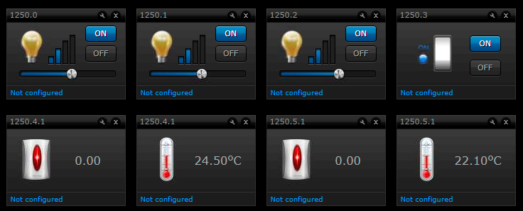

I am still having problems with the code (trying your new code as well). In setup(), g_channels_data variable is set and this is refelcted in the controller right away, no need to call zunoSendReport() apparently. If I do the same in loop(), nothing is sent to the controller, not even if I call zunoSendReport(). The end result is that it is possible to send updated from HC2 to z-uno, but not from z-uno to HC2.
So, it seems Hc2 is not working as smoothly as Razberry.
HC2 also marks the devices as "Not configured" in the user interface, there is apparently something amiss here.
Fibaro HC2.png (66 KiB) Viewed 15152 times
I am also getting these extra sensor devices that can't be set or read is seems. Not a big issue, they can be hidden, but I do wonder why the show up in the first place.
