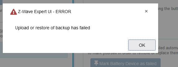

I have an Rasberry 3 with Zway v3.2.2
On Restore Controller Data. An Error appears
In wich log are furthermore Information ?
Can anybody Help ?

Re: Razberry Gen 7. Restore doesn´t work
This is known. Please open /opt/z-way-server/translations/SDKs.xml and adf 7.16 to 7.16 mapping like it is for 7.15 at the end. Restart Z-Way and it will work.
Post by J.nissen »
Thanks, it works !
