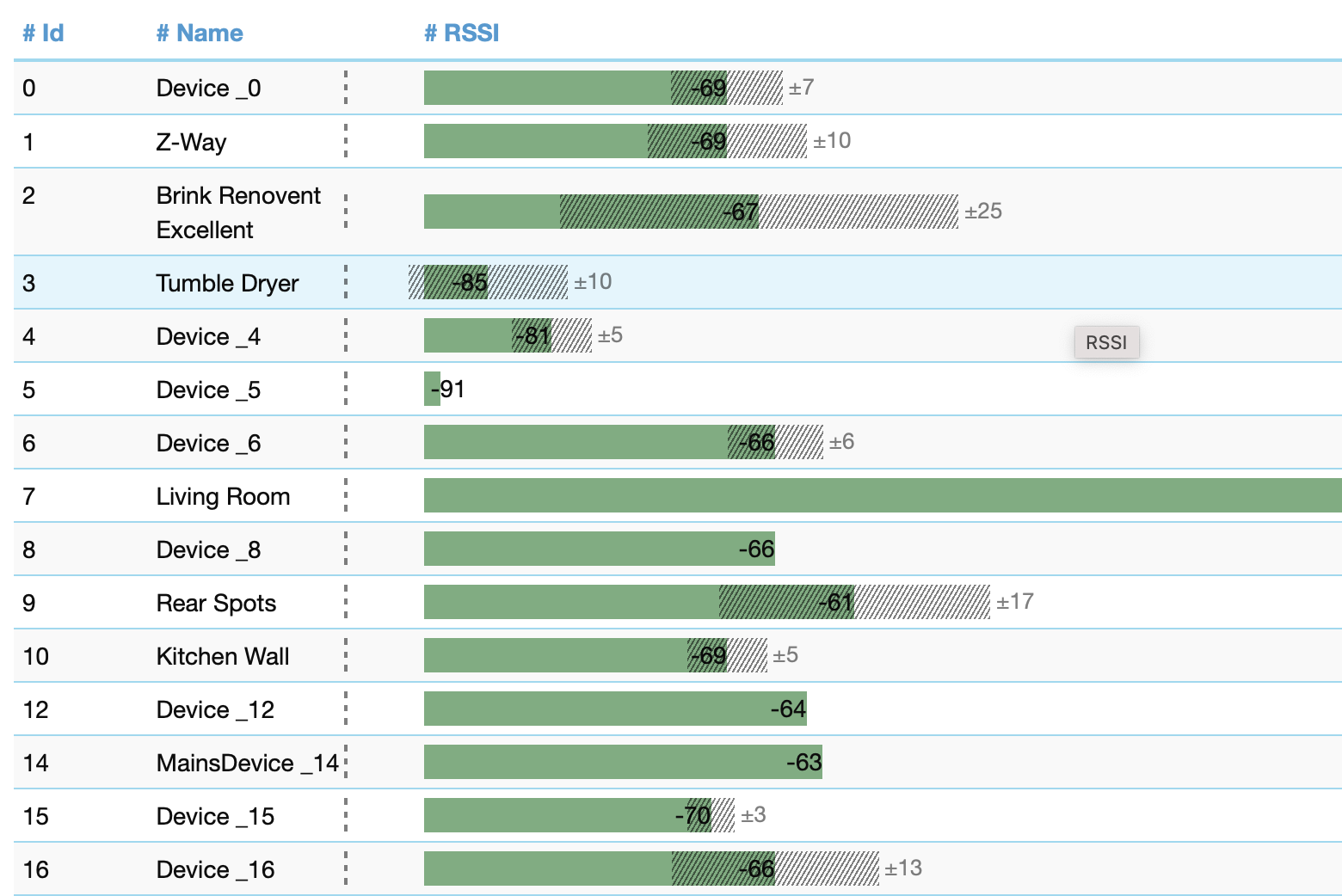

Now when checking up my network, I noticed under "Signal Strength" there were way more devices listed (e.g. device 4, 5 and 6) than actually active in the network, and even weirder, they seem to be receiving / having signal strength as well (see below screenshot).
Screenshot 2022-01-16 at 19.59.51.png (204.87 KiB) Viewed 19673 times
Screenshot 2022-01-16 at 20.00.06.png (204.65 KiB) Viewed 19673 times

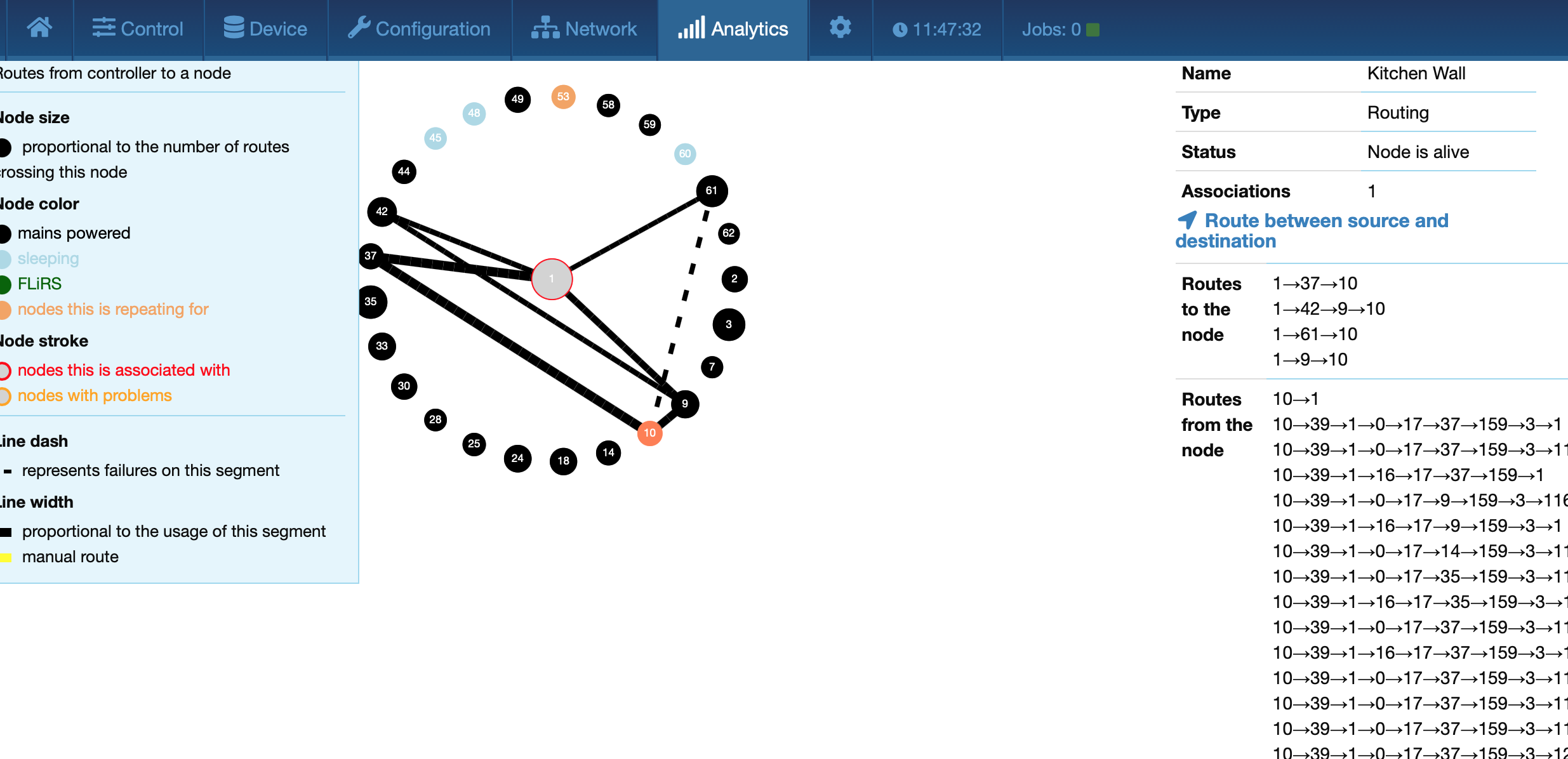

When I check the Routing Table, I also noted a number of devices reporting several "ghost" devices under "Routes From This Node" (e.g. device_39 does not exist).
Screenshot 2022-01-16 at 20.00.25.png (386.88 KiB) Viewed 19673 times

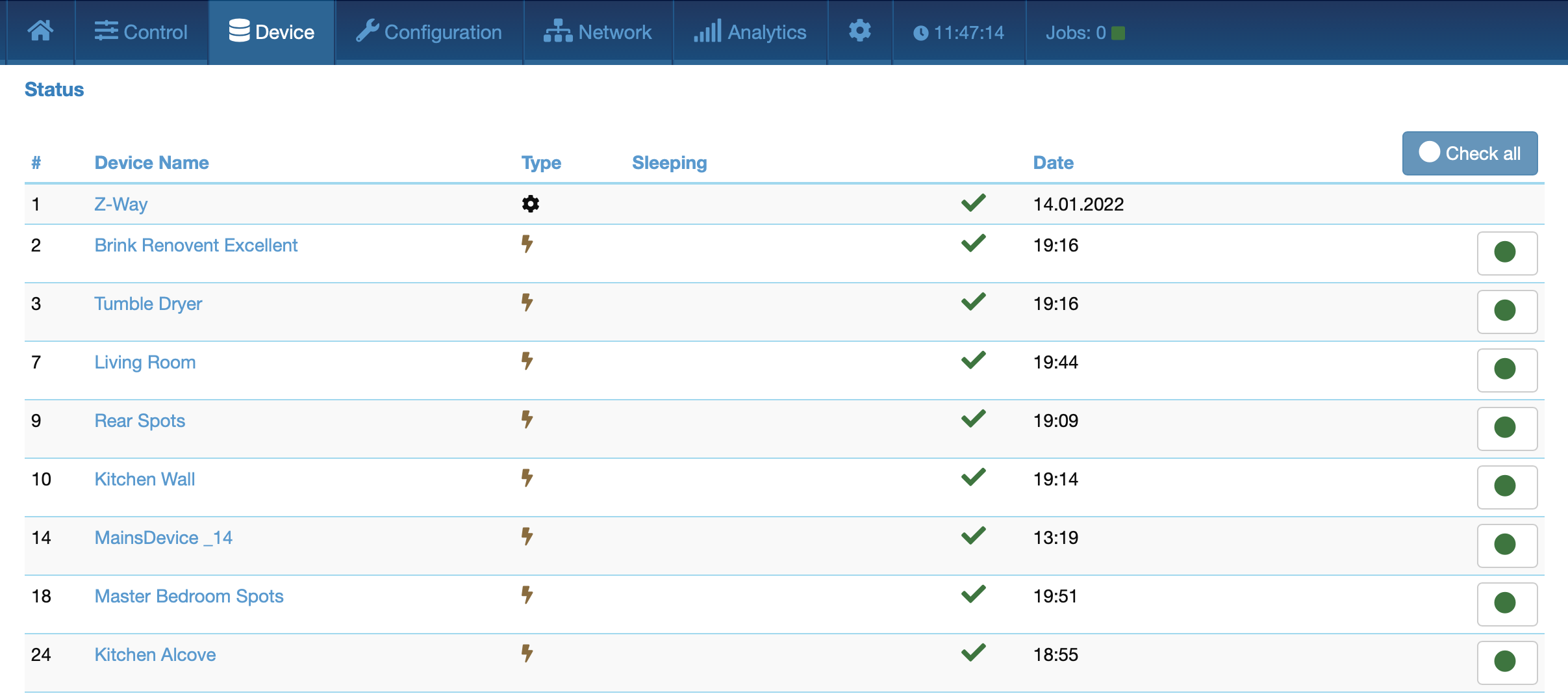

There are no failed devices listed.

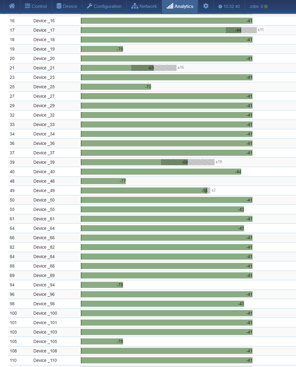

Hey @PoltoS - im having this issue at the moment. I recently installed 2x (one is using stock firmware on 7.15.00), and another on 7.17. Ive updated one of them to 7.17 and the issue still persists. I've got 2x Razberry Pro 7s to replace a single Razberry 2 (meaning there is currently 3 in operating). Im gathering its just picking up the z-wave devices on the other z-ways - I'm not sure if its problematic.
See attached image
z-way ghosts.png (73.42 KiB) Viewed 19028 times
