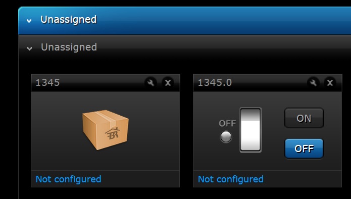

whatever I try, the result is the same : after 'said inclusion' I get only one switch, probably the one bound to chan 0, not mine...:

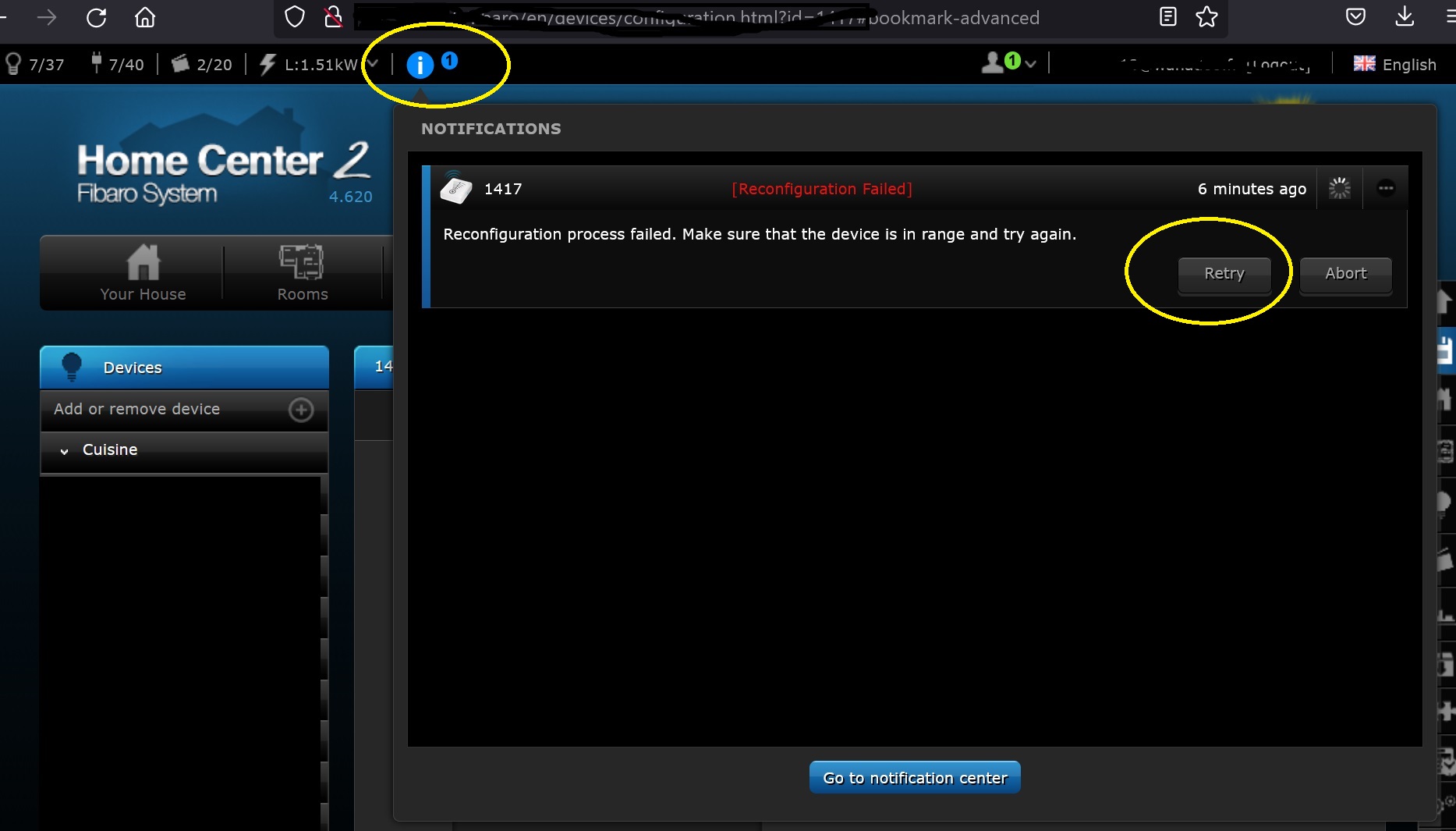

INCLUSION PROCEDURE:
1) get Z-uno2 board in rescue mode even with a ligh 'loop code' (you must have a light loop code anyways after step 11, you will replace it later)
2) start 'Add device' on HC2 and triple click on Z-uno2
3) wait & wait & wait...

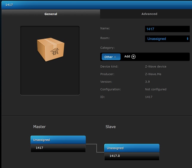

4) device is added but not configured and only lifeline appears:

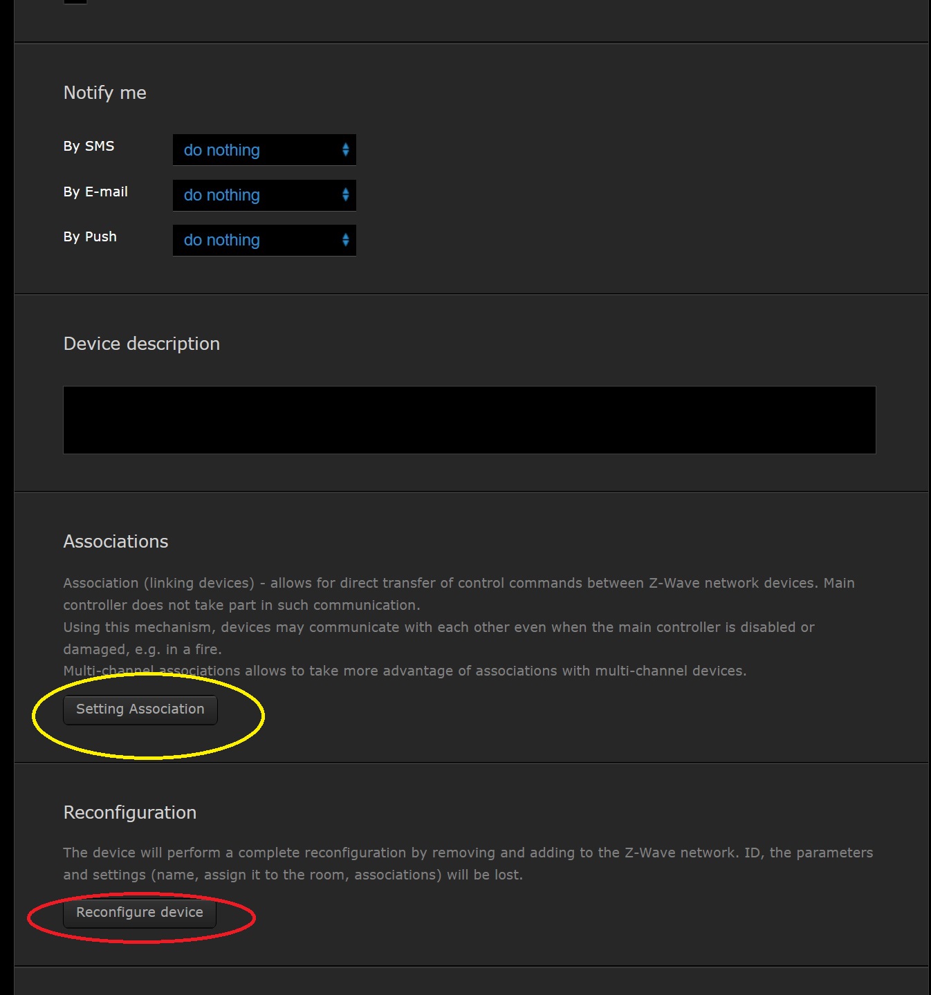

5) go to the page of the new master & to the 'advanced' tab

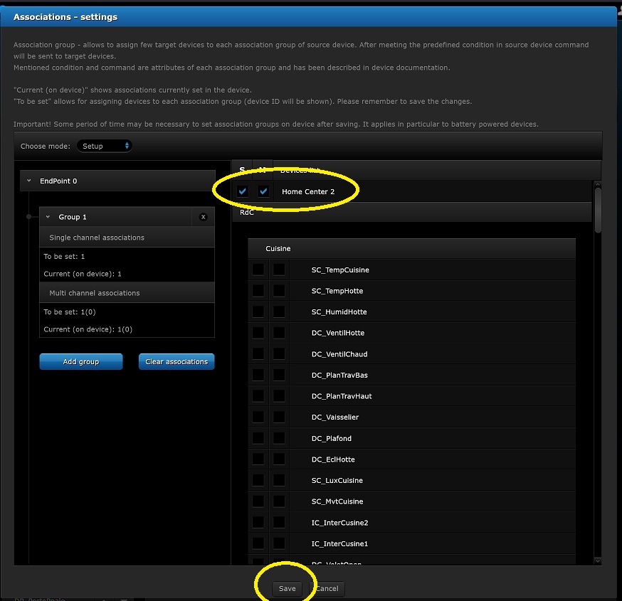

6) click on 'Setting Association' and check, for every groups, that S & M are 'ON'

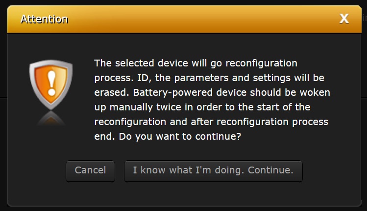

7) click on 'Reconfigure Device' (red circle above). At this stage you should still be in Rescue mode
8) In the next popup don't be shy and 'YES!!' pretend that you know what you are doing :D.
8) wait & wait & wait...
9) But most of the time it is not finished yet, as you should still be close to 4) :o !!!
10) Repeat step 6 (some other group may have appeared)
11) press reset on the Z-uno2

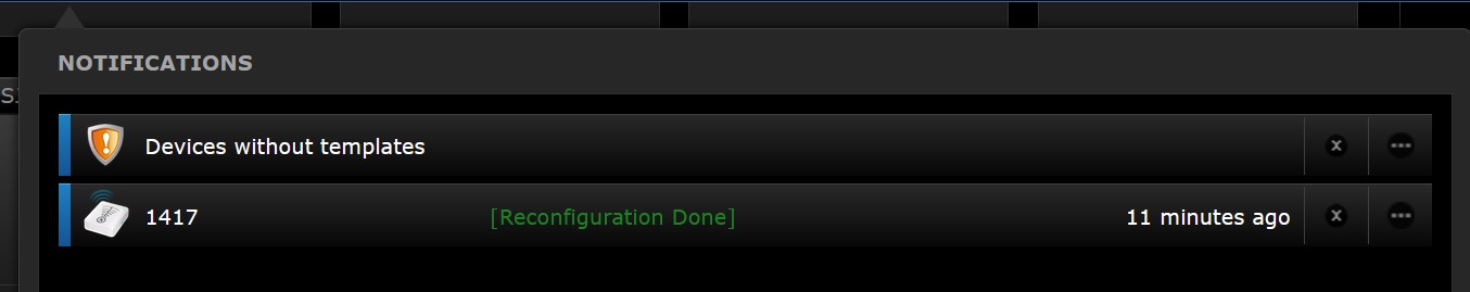

12) click in the notification icon
13) click on retry
14) wait & wait & wait...
15) this time it should be OK!!!,
If not: try again once from 10), if still KO, then suspect your code, most of the time the bug lies somewhere between keyboard and chair but, in that particular case, understanding of documentation may be also involved :-)
Have a nice day,
Yves
