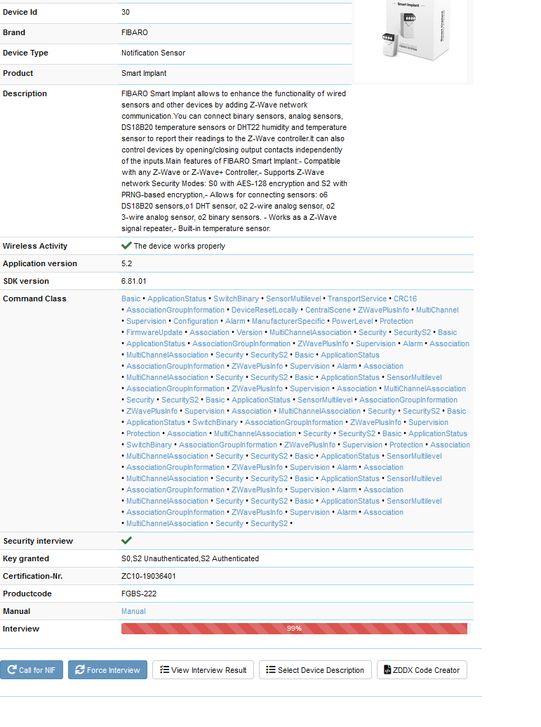

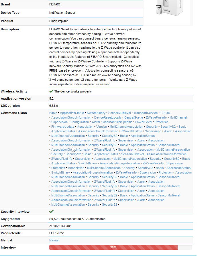

Include the univesal Sensor from Fibaro ist very difficult.
If I retry the Inclusion, irgent when it goes then. I must then but also times 10 - 20 times to get the inclusion again.
In the Fibaro HCL Lite this goes without a problem.
What can be the reason
Zway 2.3.2 with Razzberry pro
Fibaro Universal Sensor.png (72.16 KiB) Viewed 10888 times

Re: Fibaro Universal Sensor Inclusion
Please check interview results. Which Command Class is not done?

Hello Polto,
in the meantime I have pressed 1000 times more on the interviews of the individual classes and am now at 99%. So now only the class for the version is missing and this is not so important.
Since I often tinker with Universal Sensor, this behavior is only annoying
Fibaro Universal Sensor99.png (82.39 KiB) Viewed 10868 times
Thanks for your reply.

enbemokel
Posts: 499
Joined: 08 Aug 2016 17:36
Post by enbemokel »
Please show us the View Interview Result. Then we can see which Command Class is missing.
I just struggled with an old universal Sensor, you are using a smart implant. Maybe they are similiar, as the smart implant is
the successor of the universal sensor.
This helps for mulitchannel interview problems if I remember right:
http://192.168.0.148:8083/JS/Run/zway.d ... wDone=true
You have to use your IP Address and your device number.
If there is another class missing, you can use something like this:
Have Fun,
Nico
