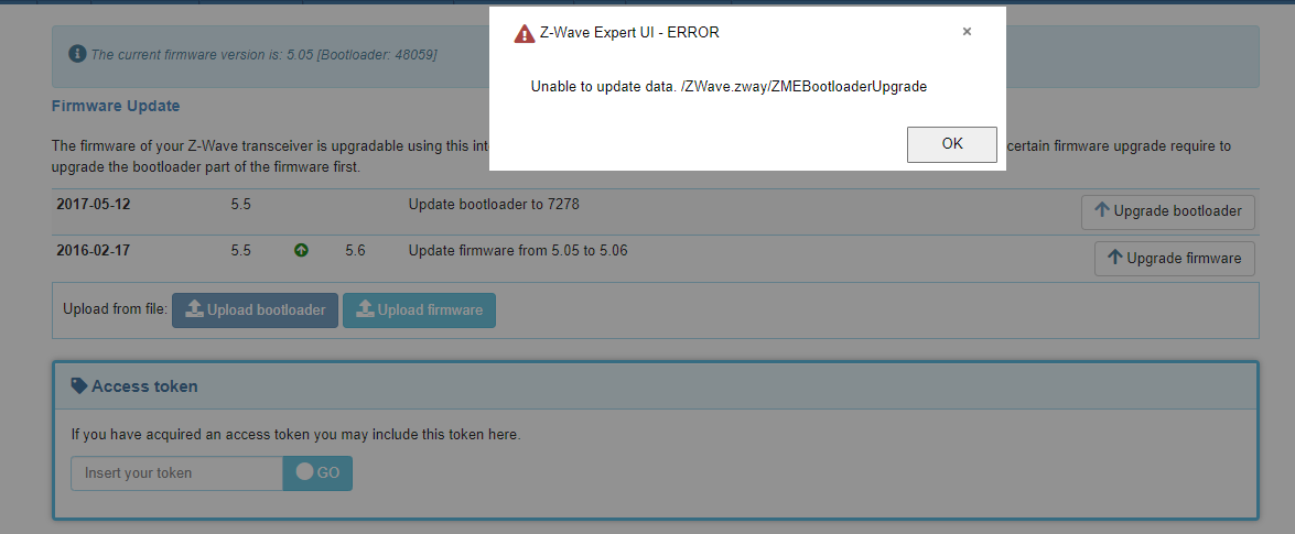

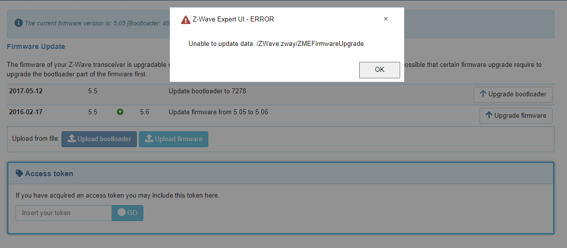

So, the situation I find myself in, using z-way 3.2.1. My usb stick is attached to the laptop, and when looking at the upgrades suggested, I see the errors:
bootloader: Unable to update data. /ZWave.zway/ZMEBootloaderUpgrade
firmware: Unable to update data. /ZWave.zway/ZMEFirmwareUpgrade
Please can you help with these errors?

- update_firmware.png (42.08 KiB) Viewed 8858 times
- update_bootloader.png (42.55 KiB) Viewed 8858 times
