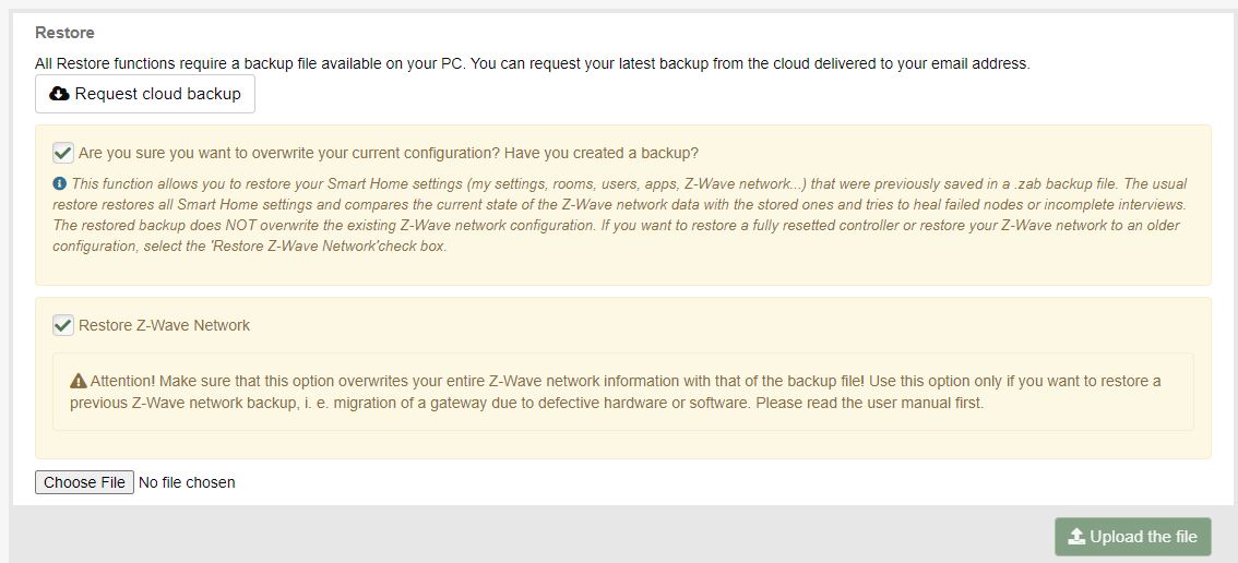

Have you tried to restore the .zab file using the smarthome UI? Your web browser should show the following and should let you upload the .zab file.

indeed, you are right. I think it worked now, am going over the configuration.
Thanks!
