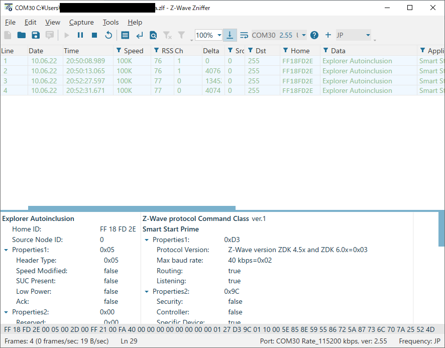

I use Z-Wave Zniffer to see the signal like this.
I expect it will show a new data when I press the button but it does not.
However I can see the Explorer Autoinclusion appears.

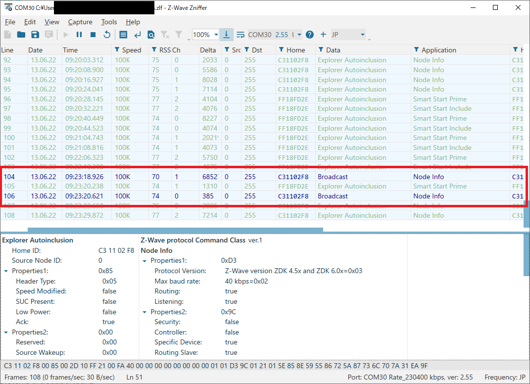

I tried zunoSendNIF() and I can see the signal through the Zniffer USB.
Here is the sample code for anyone who need in the future.
