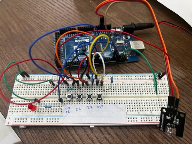

So I am familiar with Arduino and have built on Arduino MEGA2650 the ability to send Raw Date of IR signals to the AC. And it is working great. Now, I would like to extend it with Z-Uno to be able to control the command from the Z-Wave Controller based on user selections e.g. Set temperature at 24C. Ultimately propagates the command to the Z-Uno and then to my code to send the Raw Data through the IR Transmitter to the AC.
