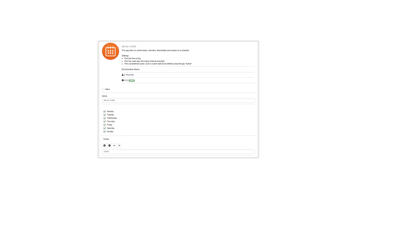

I tried to use the app "Schedule" with "0-59/2" in field Times . I don't know if is correct .(see attachment)
