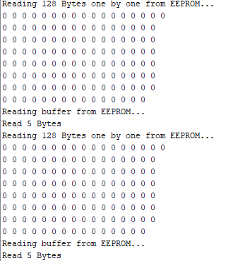

I am trying to write to the EEPROM to save data during power cycles. Just to test our that the EEPROM works properly, I used the example code on https://z-uno.z-wave.me/Reference/EEPROM/. Nothing gets stored in the EEPROM, just 0's. In addition I have tried to use EEPROM.write to write directly to a specific memory address and the entire memory is filled instead of just one memory location. Furthermore, when I cycle power nothing is saved. Any help would be appreciated. I am using a Z-uno2 rev.6

Hello.
Can you show the console output?
graham
Posts: 4
Joined: 14 Jul 2022 22:15
Re: EEPROM example code not working properly
Post by graham »
hi, here is the console output...

Which software version do you use? With larger v 3.0.7 an EEPROM problem was fixed.
graham
Posts: 4
Post by graham »
I am using Arduino IDE v 1.8.19, not sure if that is what you are asking for.

no, the Z-uno2 version in "Boards Manager" ... https://z-uno.z-wave.me/arduino-install/

on v 3.0.9 it works fine so maybe you should update the software - probably this will fix the problem
graham
Posts: 4
Post by graham »
That fixed it! I wasn't using the Beta board, that was my issue.
