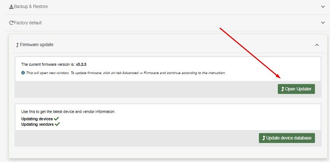

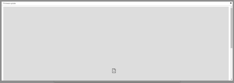

Clicking the Open Updater button opens a blank page.
Moreover, this situation also occurs on another Raspberry with Razberry 2

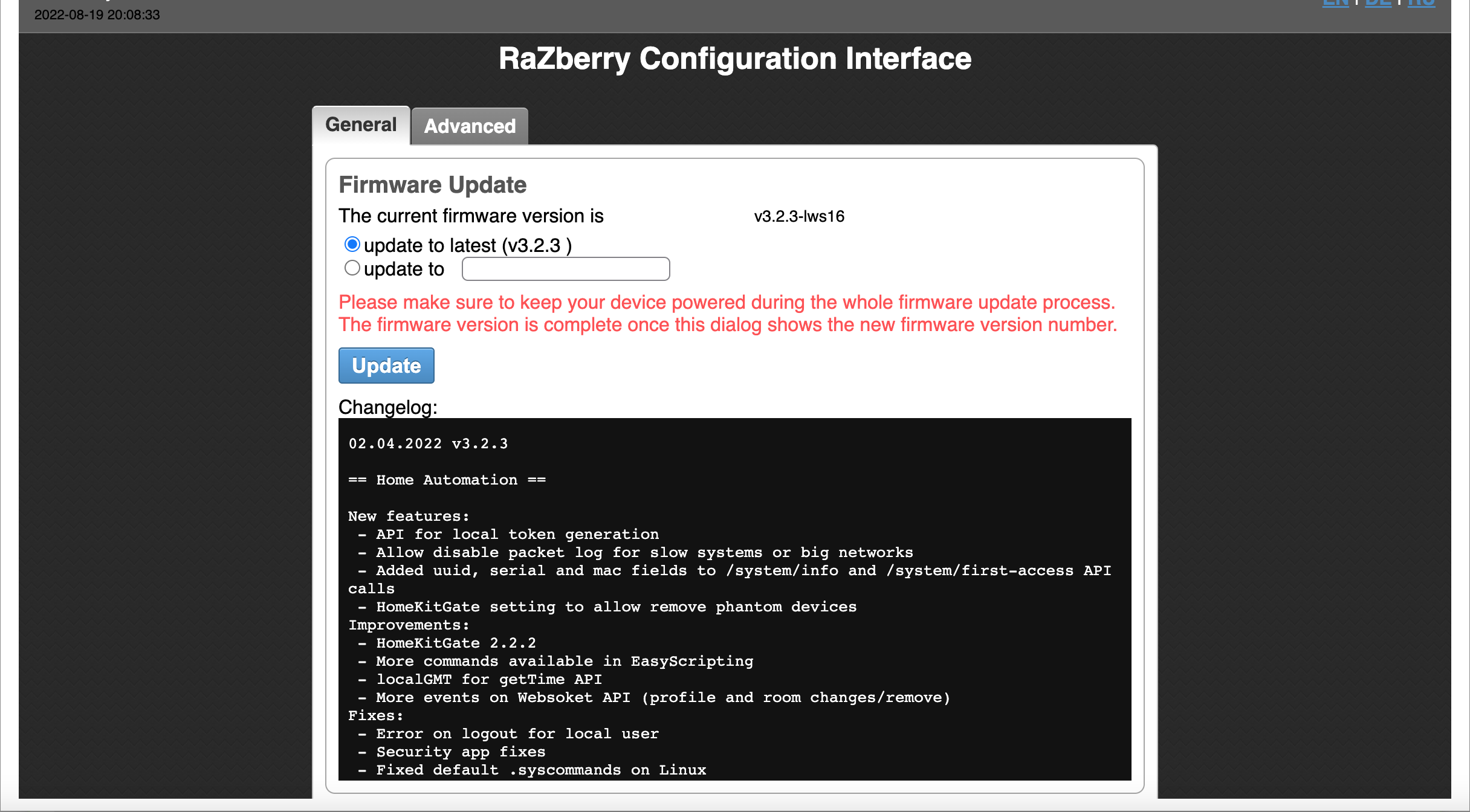

When you click on Upgrade button, a page with the UI shown above should open. I got you that you have a blank page.
Please open the browser console to see why the page is blank. You can also try to access the page directly: it is http://RPi_IP:8084 (same as for the UI, but with port 8084 instead of 8083). What do you see here?

Port 8084 - blank page.

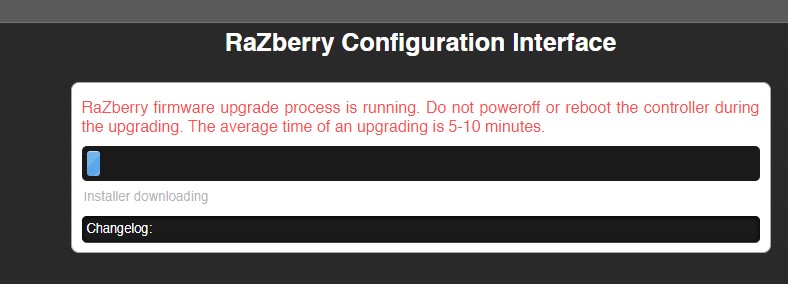

In the interface
The update can last indefinitely, and will not end.

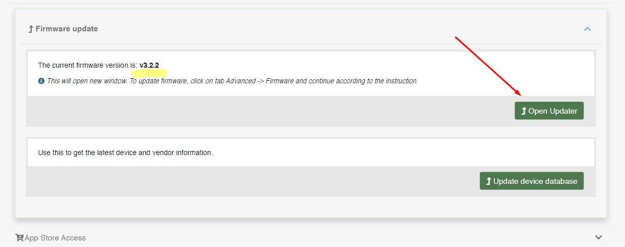

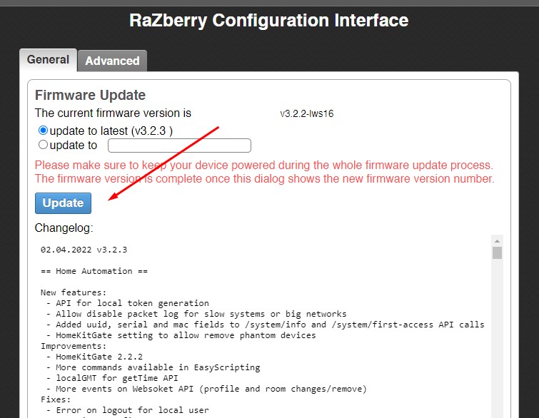

I tried to install Z-Way on Raspberry Pi OS Full, the problem remained.
Version 3.2.2 does not have this problem.
Everything opens as it should.
