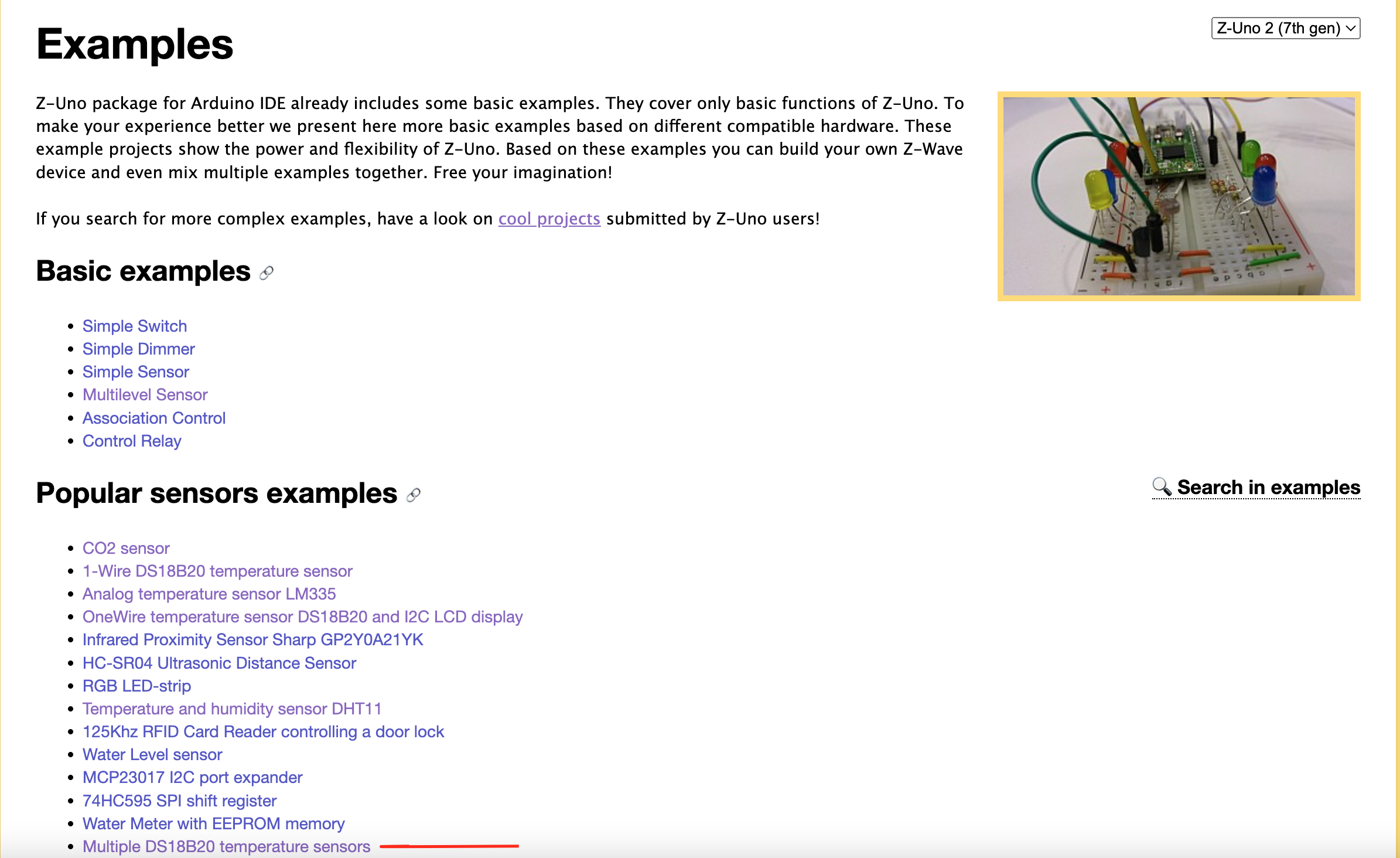

Judging by "Preprocessing file: Custom.c with SDCPP..." you have chosen 5th Gen device type.
How exactly did you choose the 7th Gen device type?
Here is a link to an example for 5th Gen device type:
https://z-uno.z-wave.me/examples/onewir ... Version=v1
Here is a link to an example for 7th Gen device type:
https://z-uno.z-wave.me/examples/onewir ... Version=v2

What is strange is that on this page if I select in the upper right Z-Uno 2 (7th Generation)
If I select
Multiple DS18B20 temperature sensors
which should be a Z-Uno 2 (7th Generation board), it takes me to this sketch:
https://z-uno.z-wave.me/examples/multip ... e-sensors/
There is no drop down in the upper right, so based upon it being listed on the Z-Uno 2 (7th Generation) page, it should be the current board that is being sold.

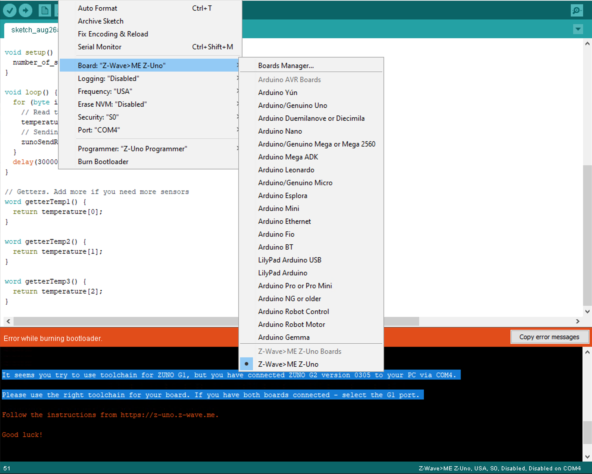

If I try to burn the bootloader I get this error message:
It seems you try to use toolchain for ZUNO G1, but you have connected ZUNO G2 version 0305 to your PC via COM4.
Please use the right toolchain for your board. If you have both boards connected - select the G1 port.

So I figured out the issue but a new one has arose to still stop any progress. The documentation lists to add this url:
https://z-uno.z-wave.me/files/z-uno/pac ... index.json
It should actually be this URL:
https://z-uno.z-wave.me/files/z-uno2/pa ... index.json

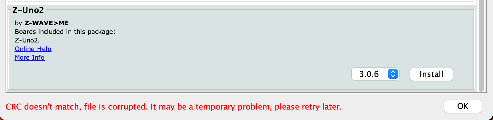

The issue I now I have, trying to install Z-Uno2 fails the CRC check. I have tried this under Windows and macOS also using 1.6.5 and even 1.8.19 on both.

Ok, so the issue is indeed with the documentation for the Z-Uno G2 documentation. It listed the wrong URL for the G2 so the toolchain being used was for the G1. Changing the URL (which I took a guess on) for the Z-Uno2, did allow the correct dependencies to show in the board manger. However, the checksums were not correct and thus wouldn't install. As a workaround, I looked at the json file and saw all of the files in it. I downloaded them to the machine I have the IDE installed on. I then started a web server on it. I modified the json file to remove the checksums listed and also to change the path to use the local web server for the files. This allowed for the installation of 3.0.6 for the Z-Uno2 and allowed me to compile a sketch and burn the bootloader.
So Z-Wave.me needs to update the documentation for the correct URL and look into the checksum error.
Re: C++ requires a type specifier for all declarations
For the checksum error, please delete all downloaded files in stage folder in .arduino/hardware/z-uno (click in settings window to open this folder).
As for the G1/G2 and docs, on which page you found incorrect information that confused you?

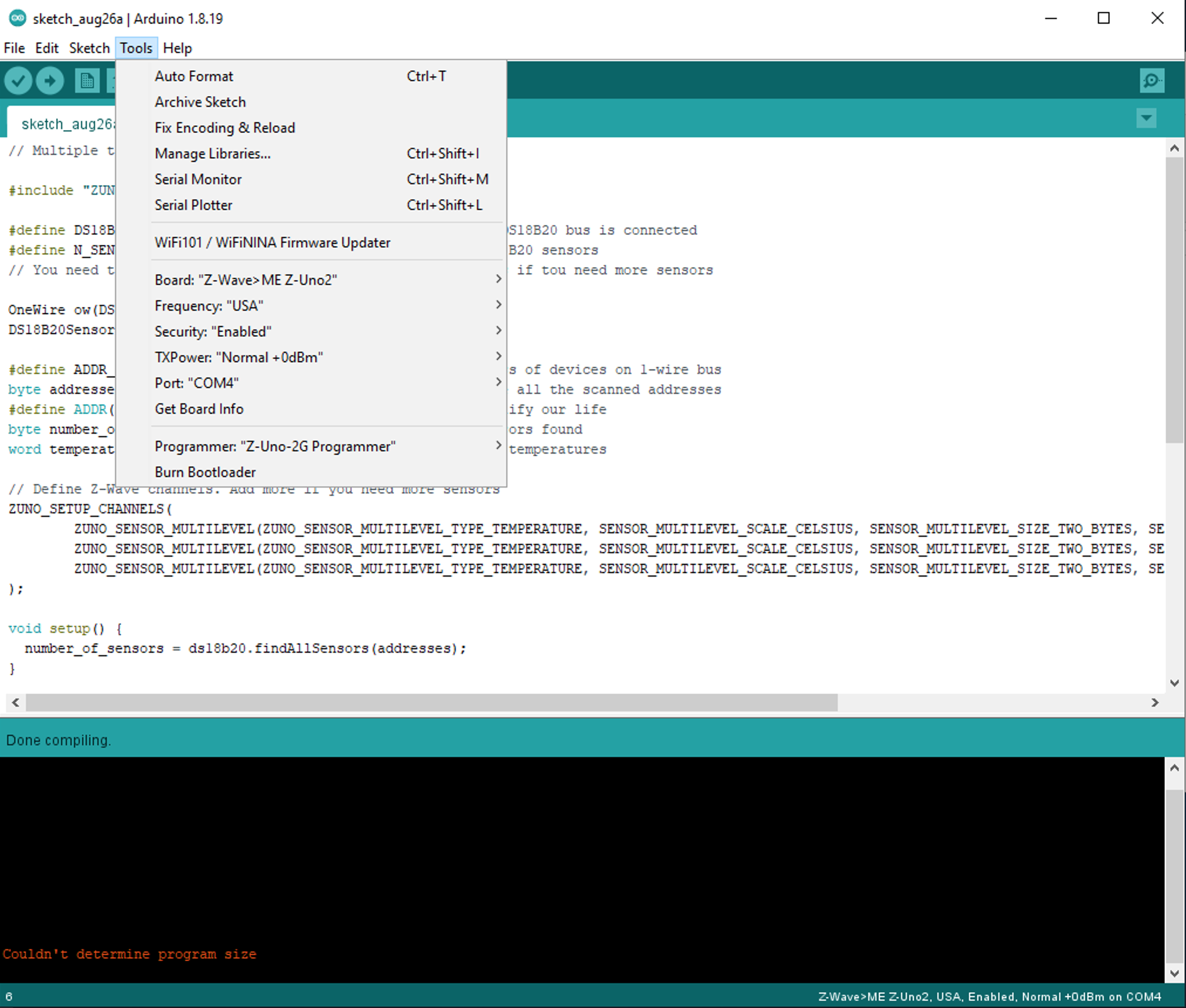

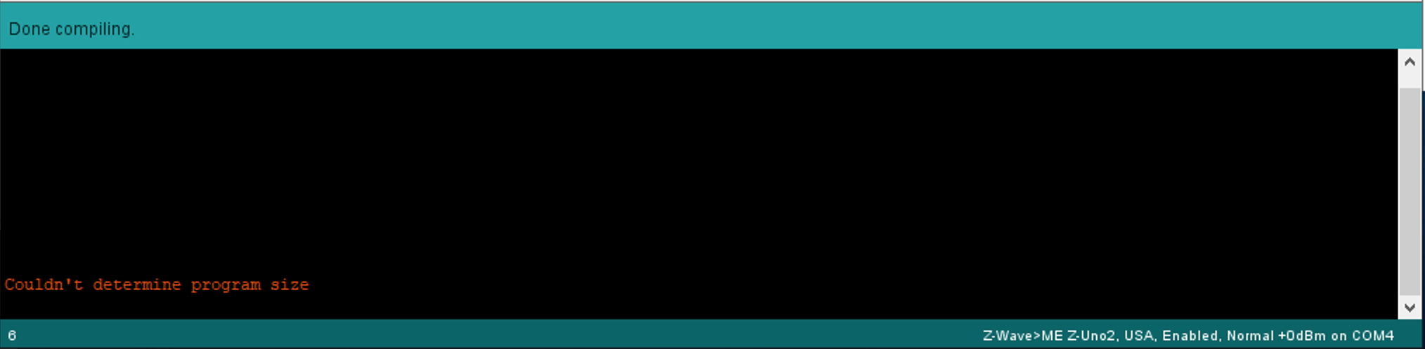

For the 7th Gen. What release of the IDE should be used? In the Quick Start Guide lists 1.6.5 but that also appears to be for the 5th Gen. I do get a compile error on the sketch that is direct from an example. So I want to rule out it could be the IDE version I'm using as it is 1.8.19. I upgraded to it to see if the CRC errors went away...which they did not.
The errors seen are:
Traceback (most recent call last):
  File "site-packages\PyInstaller\loader\pyiboot01_bootstrap.py", line 151, in __init__
  File "ctypes\__init__.py", line 373, in __init__
FileNotFoundError: Could not find module 'C:\Users\User\AppData\Local\Arduino15\packages\Z-Uno2\tools\libClang\11.0.1\libclang.dll' (or one of its dependencies). Try using the full path with constructor syntax.
During handling of the above exception, another exception occurred:
  File "site-packages\sealang-3.9.dev259750-py3.8-win32.egg\clang\cindex.py", line 4014, in get_cindex_library
  File "ctypes\__init__.py", line 451, in LoadLibrary
  File "site-packages\PyInstaller\loader\pyiboot01_bootstrap.py", line 153, in __init__
PyInstallerImportError: Failed to load dynlib/dll 'C:\\Users\\Administrator\\AppData\\Local\\Arduino15\\packages\\Z-Uno2\\tools\\libClang\\11.0.1/libclang.dll'. Most probably this dynlib/dll was not found when the application was frozen.
  File "\\vmware-host\Shared Folders\Code\ZUno\G2\ZMEToolchain\zme_make.py", line 608, in buildSketch
  File "\\vmware-host\Shared Folders\Code\ZUno\G2\ZMEToolchain\zme_make.py", line 121, in convert_sketch
  File "zme_preproc.py", line 1189, in preproc_sketch
  File "zme_preproc.py", line 359, in initCLang
  File "site-packages\sealang-3.9.dev259750-py3.8-win32.egg\clang\cindex.py", line 153, in __get__
  File "site-packages\sealang-3.9.dev259750-py3.8-win32.egg\clang\cindex.py", line 3981, in lib
  File "site-packages\sealang-3.9.dev259750-py3.8-win32.egg\clang\cindex.py", line 4019, in get_cindex_library
clang.cindex.LibclangError: Failed to load dynlib/dll 'C:\\Users\\User\\AppData\\Local\\Arduino15\\packages\\Z-Uno2\\tools\\libClang\\11.0.1/libclang.dll'. Most probably this dynlib/dll was not found when the application was frozen.. To provide a path to libclang use Config.set_library_path() or Config.set_library_file().
Couldn't determine program size
I did verify that the file referenced as missing is actually there. I cannot speak about the dependencies though.
Hello.
Use these links:
z-uno 3.7
http://z-uno.z-wave.me/files/z-uno2/pa ... ndex.json
z-uno 3.9 beta
https://z-uno.z-wave.me/files/z-uno2/p ... ndex.json
