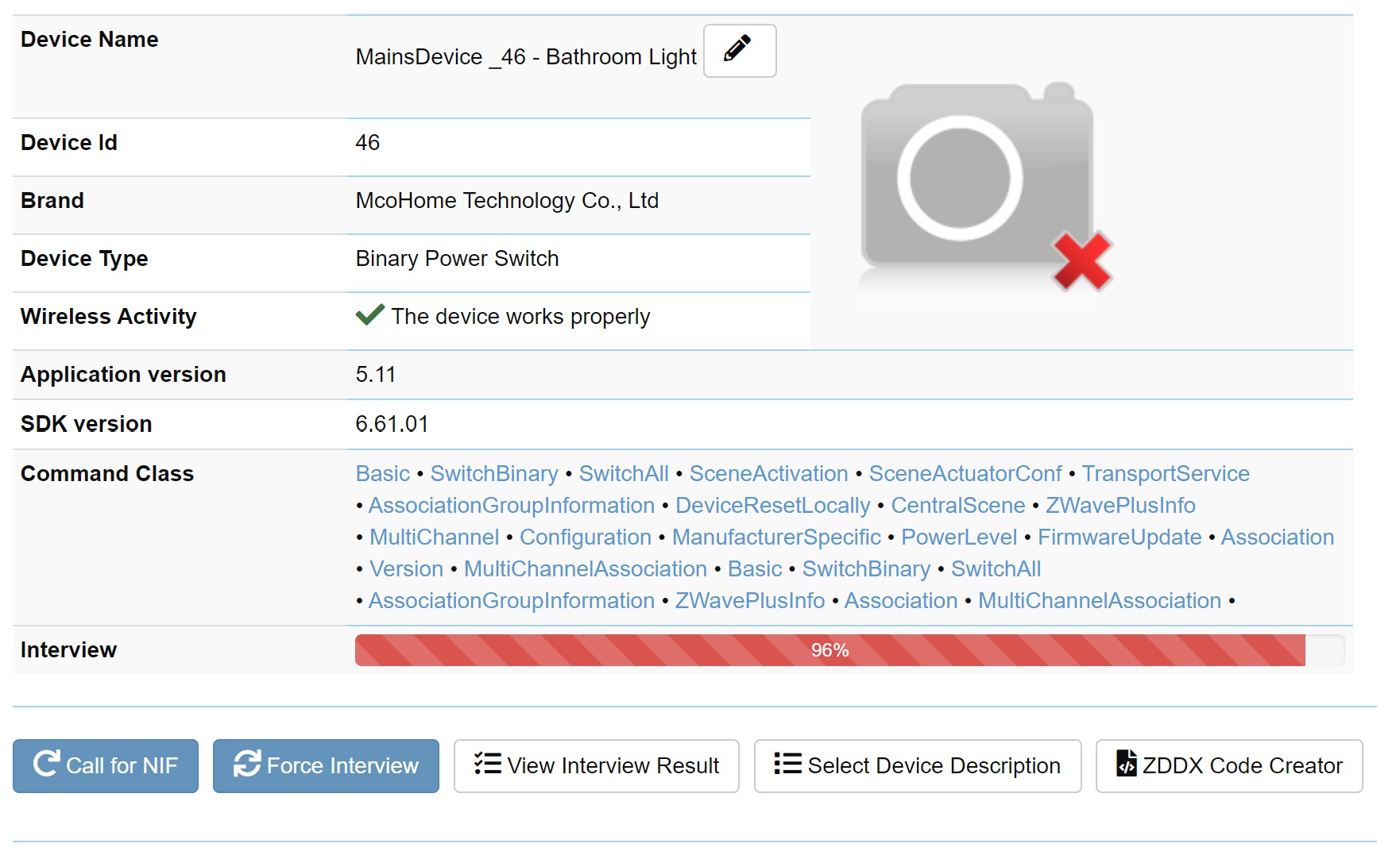

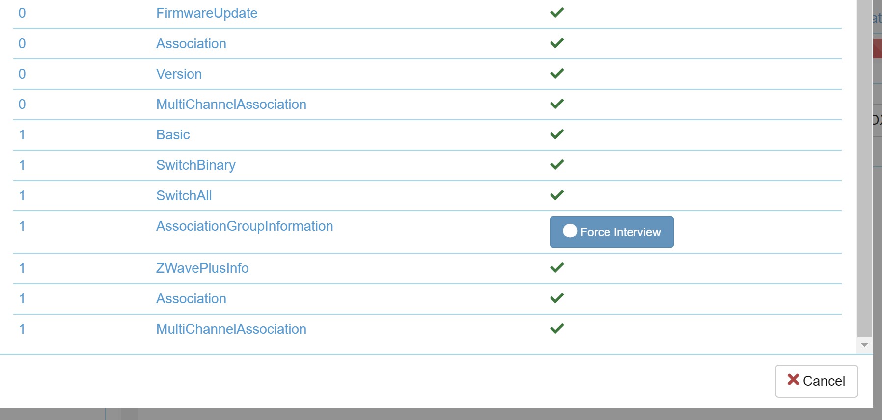

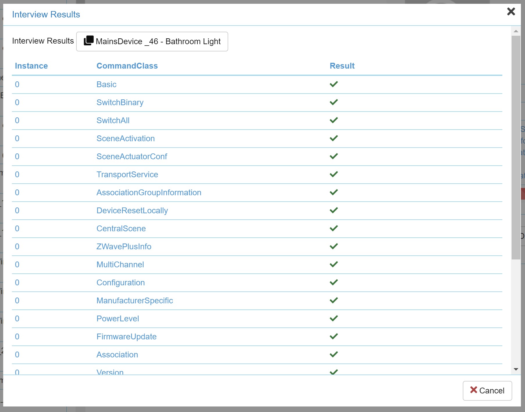

Cleared down the item.
and re added.
Slightly different result, but still stuck at 96%

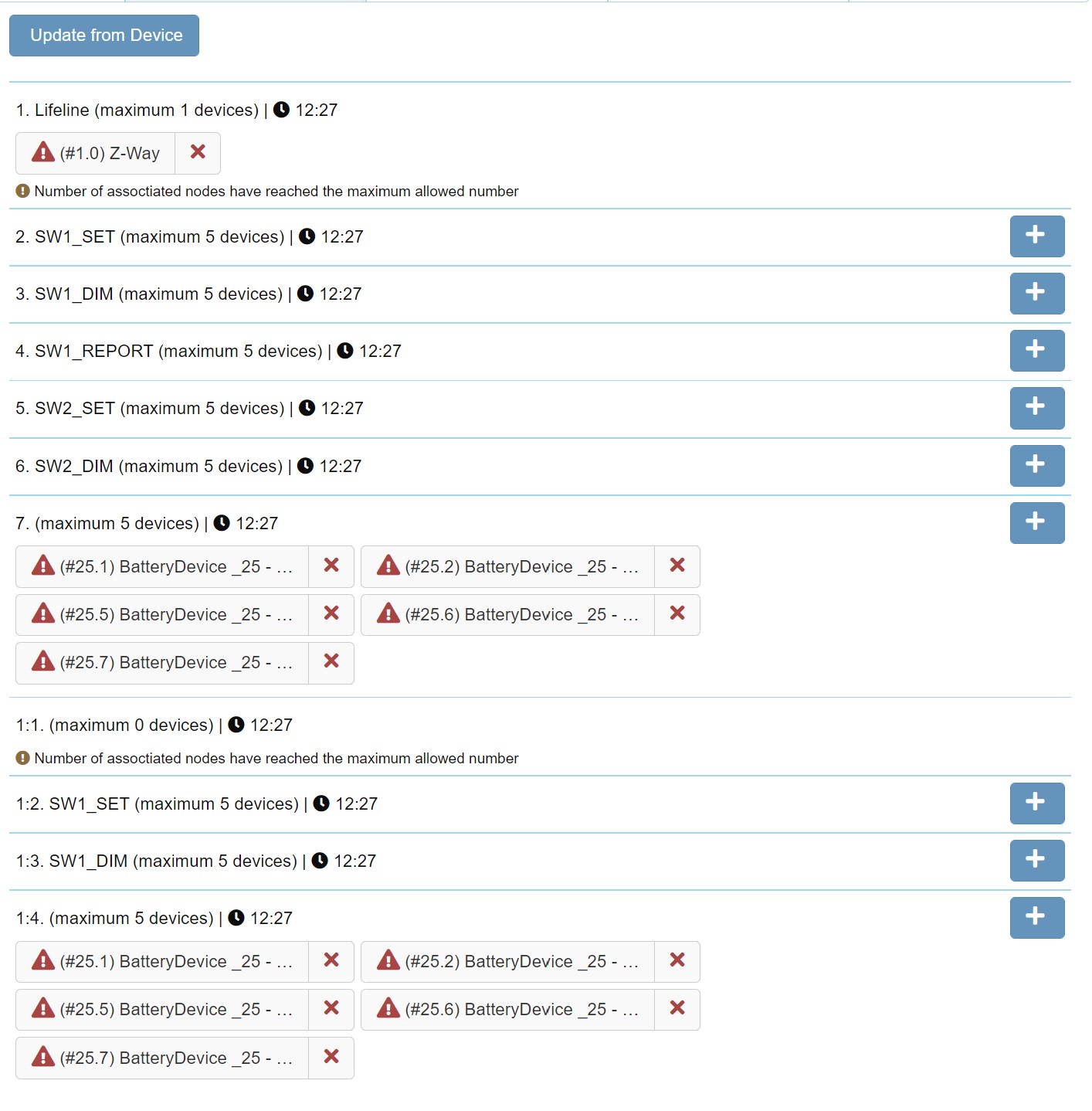

It has also associated with other devices, that i have not selected??

Re: McoHome MH-S411 - Interview failure
Looks like a missing reply from the device. Might be RF problem or the device is busy and forgets to answer. Anyway, this is not critical. Either Force interview of just mark it as done via the API.
