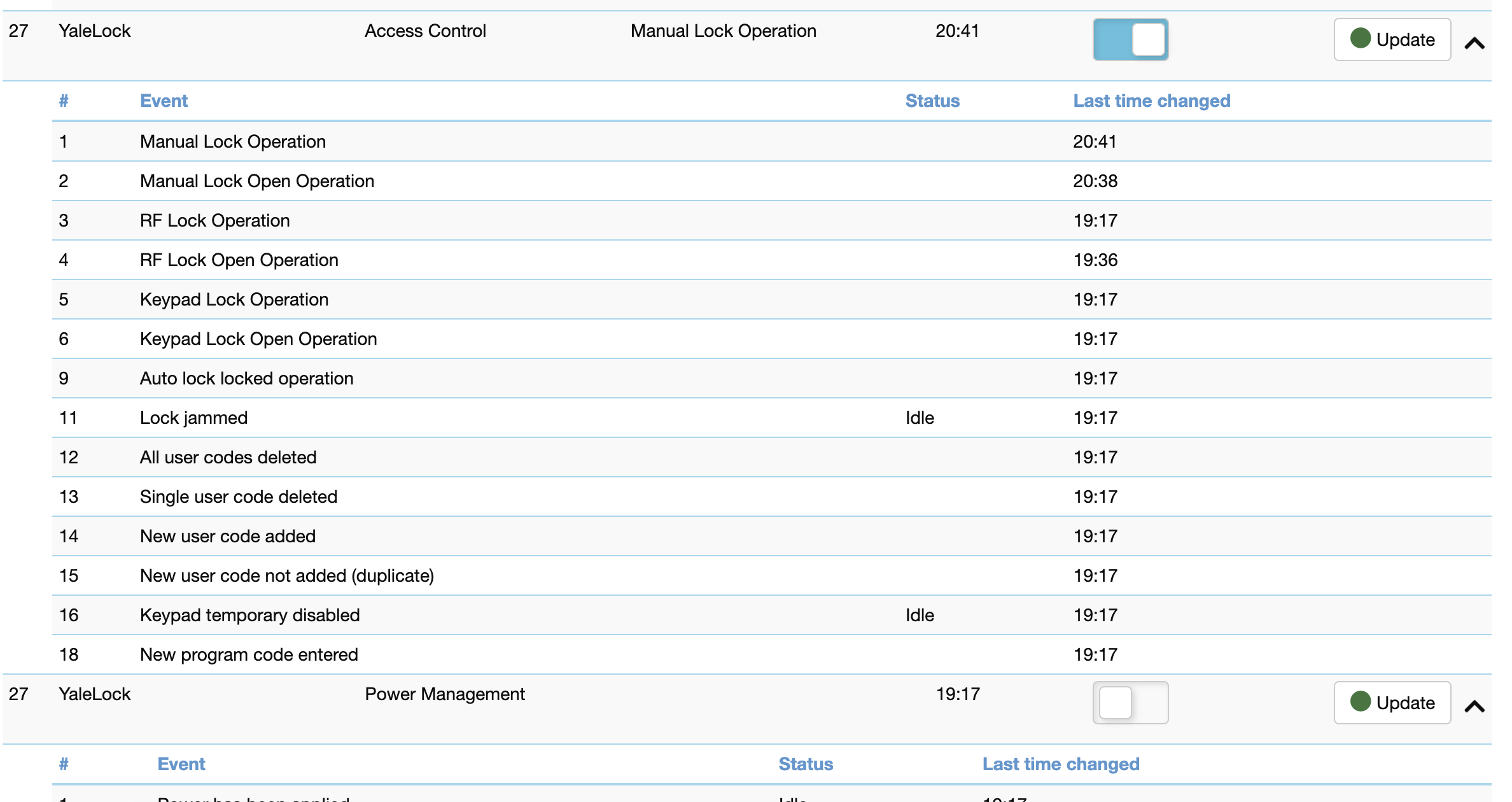

Coming into an issue now wherein, i can see the events/notifications on the Z-way child controller, but the information is not visible on the Z-way master (i can control the lock from the master, but thats about it). I cant quite work out why this one device is not reporting the additional parameters.
If it matters, the device is a Yale YRD446 lock. (ive attached a screenshot) - so none of these parameters are being passed to the Z-way master, but i can see the objects populated there - hope that makes sense.

So, the lock,unlock status is actually the only thing i want - the rest is not necessary for me. My issue at the moment is, i have no way to verify the actual (manual) lock status in HA without this report (and HA only polls from the master zway, but that obviously cant see it). Screenshot is from an end zway node

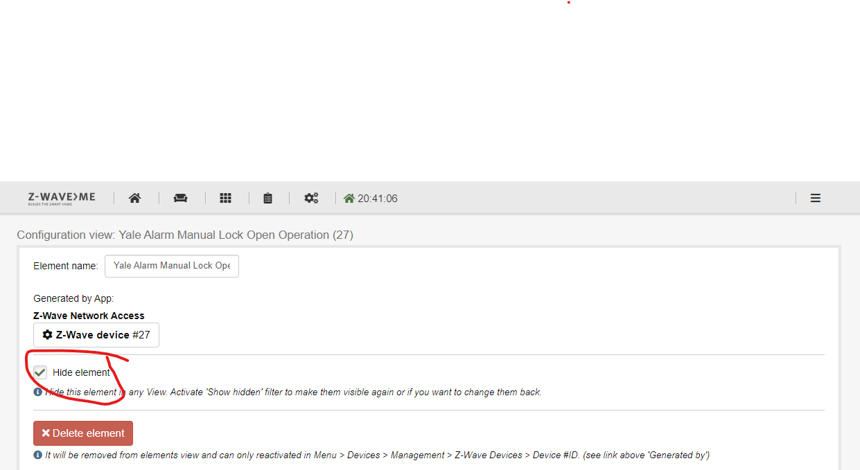

Those new events appeared in v4.0.0 and are by default hidden not to frustrate you with 15 devices instead of only one. But you can go in lock settings in the Smart Home UI and check them to become visible. They should appear in the master Z-Way too. (invisible and permanently hidden are not exported to remote Z-Way).
Re: Z-way (Link to other Z-way app) - Master Z-way missing events from child-zway
I removed the Hidden checkbox on the (Source) Z-way system (picture), but found this did not resolve the issue. Also i tried to to manually remove the entity under Smart Home UI (Z-way Master), thinking i could resync the item, but the deleted objects dont come back. I tried to remove the 'Connecting to other Z-way' app and reinstall it, but that doesnt recreate the object - any advice on that as well?PoltoS wrote: ↑28 Jan 2023 17:10Those new events appeared in v4.0.0 and are by default hidden not to frustrate you with 15 devices instead of only one. But you can go in lock settings in the Smart Home UI and check them to become visible. They should appear in the master Z-Way too. (invisible and permanently hidden are not exported to remote Z-Way).
