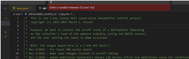

davidtheITGuy
Posts: 27
Joined: 24 Sep 2021 03:55
Re: Bug in Plugin for Visual Studio Code
Post by davidtheITGuy »
Ok using the VSC, Zuno2 Utilities menu option and entering in a floating point value (e.g. 4.0) worked! The power value in the zuno.json file seems to be ignored (currently I have it set to 40, does it need to be a floating point value as well such as 4.0?). Regardless, setting the power value in the utilities seems to have done the trick. Thank you for your assistance.
